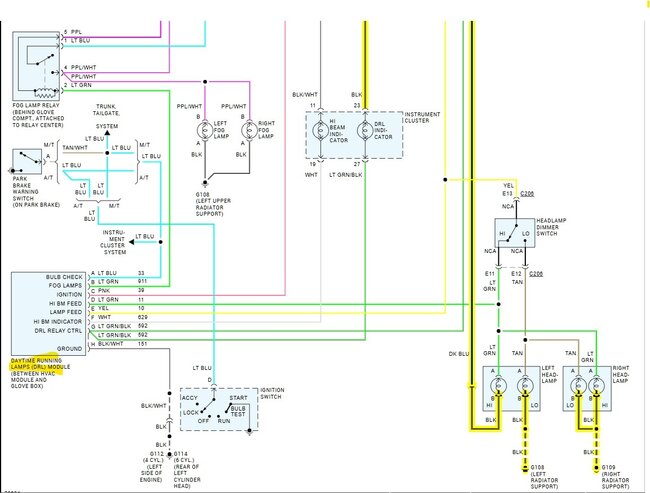

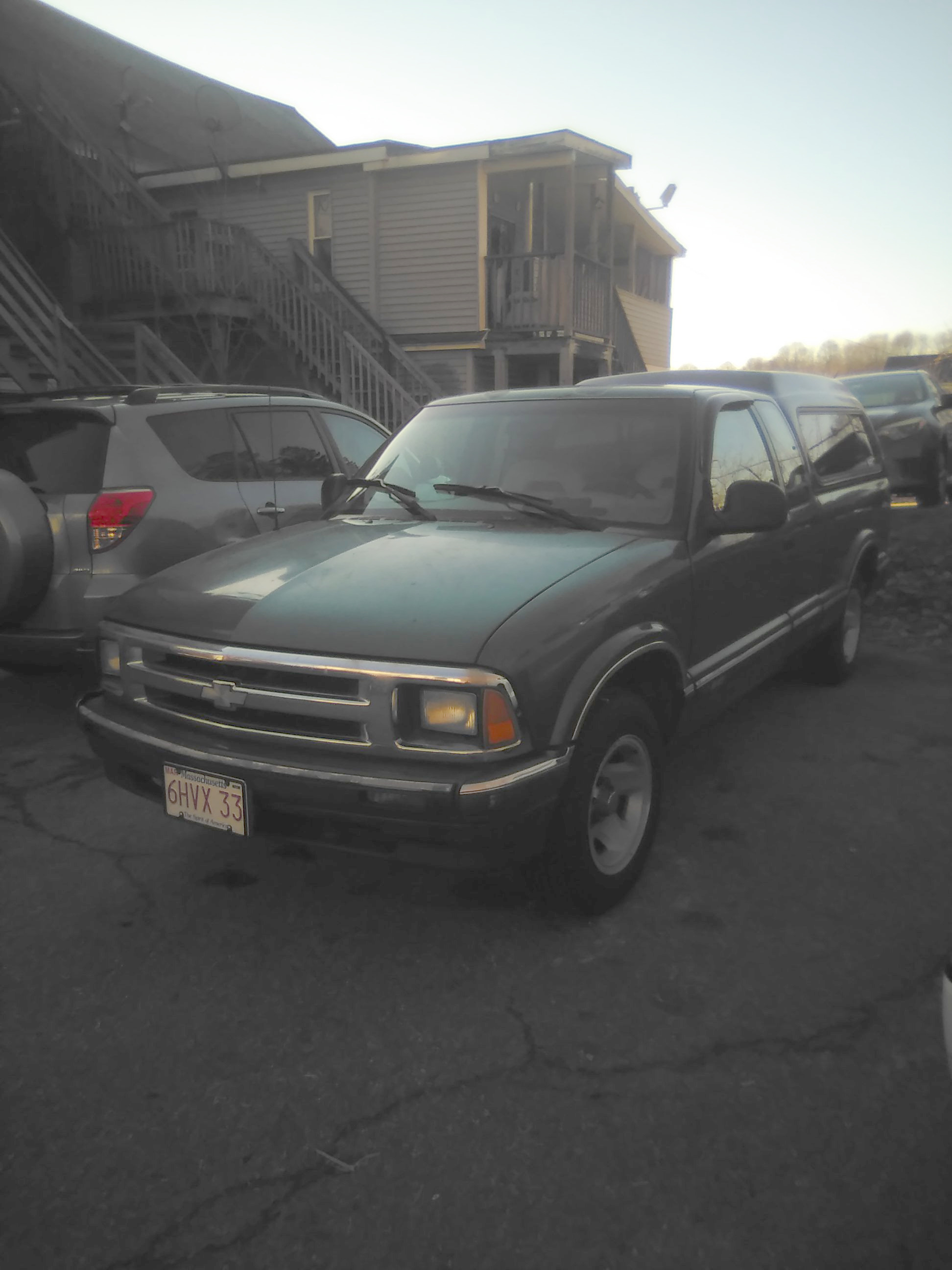

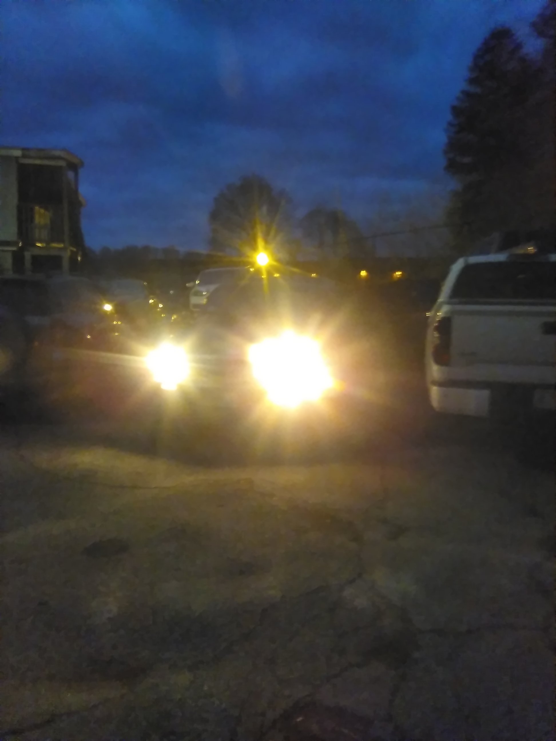

I bought a 1996 S-10 pickup 4.3 liter and last night both headlights were flickering on and off.
The high beam indicator on the dash which is blue in color flickered along with the headlights.
When I got home and put the vehicle in park both headlights were still flickering on and off and then they worked good. Today the headlights worked o.k.
I was wondering if you could E-mail me a wiring diagram of the headlights. Especially the location of where the ground wire bolts to the frame or chassis. I suspect a partially broken wire or corroded ground terminal is my first thought.
What is the easiest way to check the ground circuit?
What do you think about my lights?
I also forgot to mention I have daytime running lights on this truck, only the headlights come on not the running lights.
Thanks Al your friend Bruce Duncan

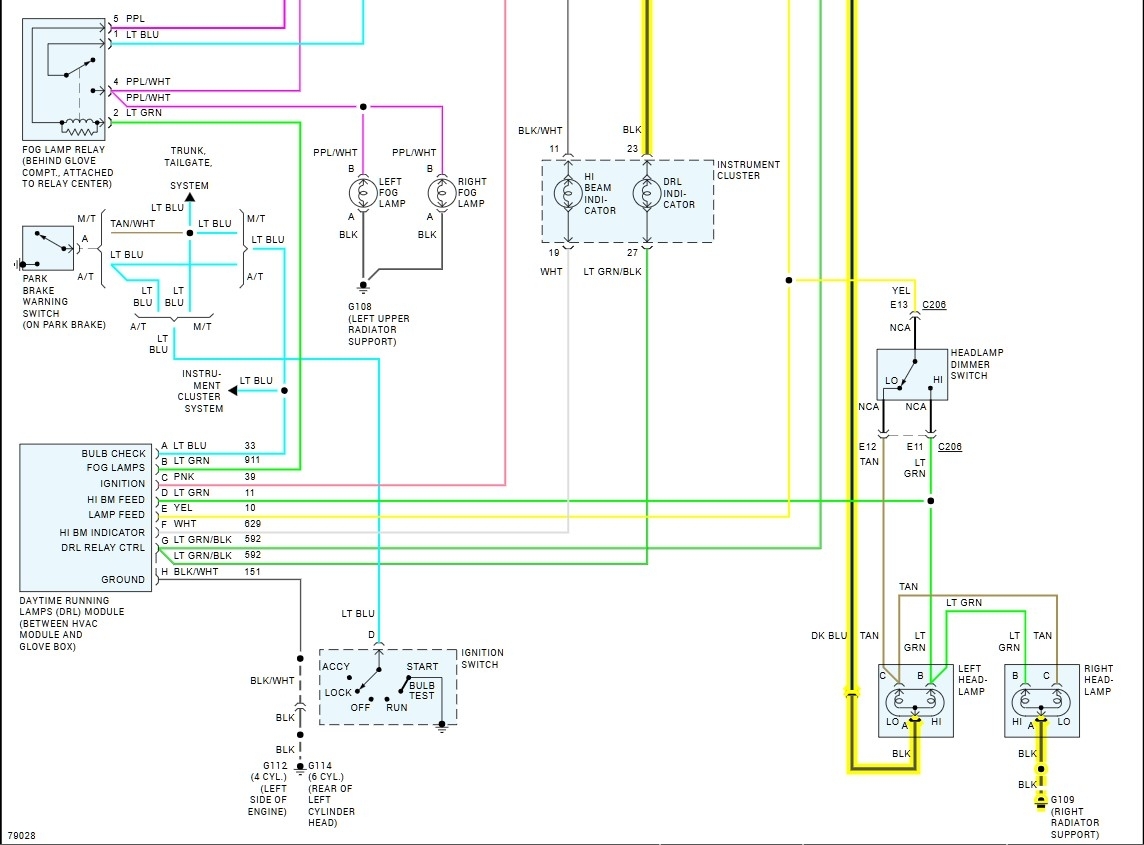

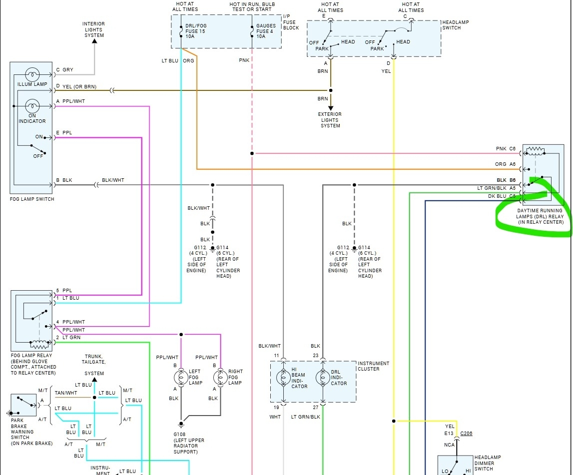

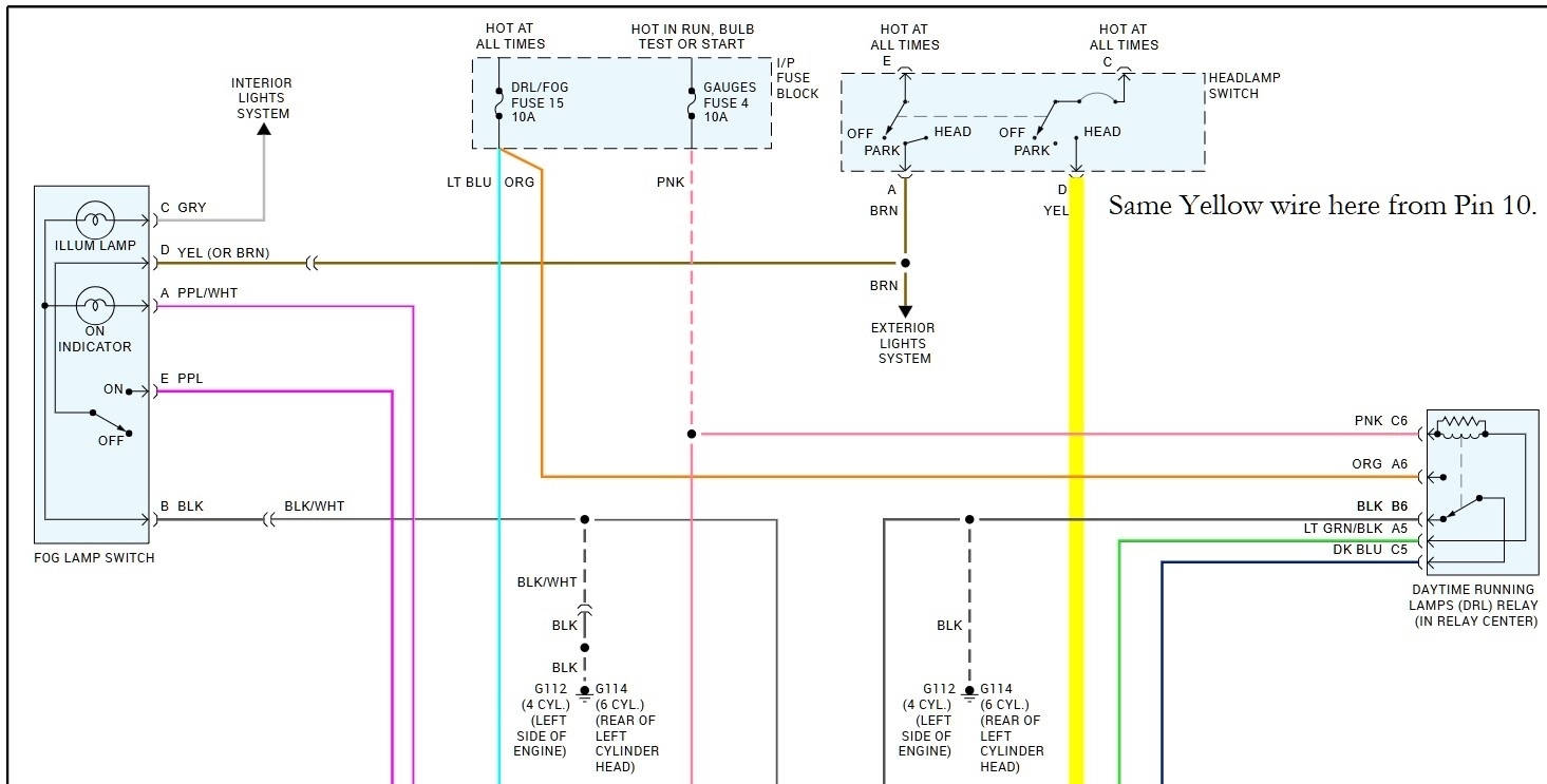

Hey there Bruce, I will grab those diagrams for you right now. The Daytime running lamp system has its own control module. Have you taken a voltage reading right at the Alternator stud? Since the head lamps are a high current draw, see if you have good charging system voltage with the head lamps on, that will load the electrical system. I would see what youre getting for voltage right at the headlamp connector as well.
I will get the wiring diagrams ready for, but checking for voltage drop when the circuit is loaded with the headlamps on, both on the positive and negative side to see if there are any connection issues on either leg. Pretty strange on the Monti Carlo,.
Jan 12, 2026 at 1:05 AM
AL514
  • 5,692 POSTS

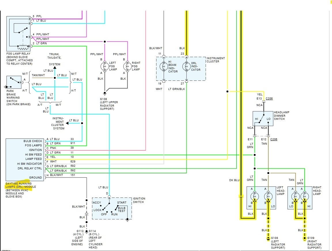

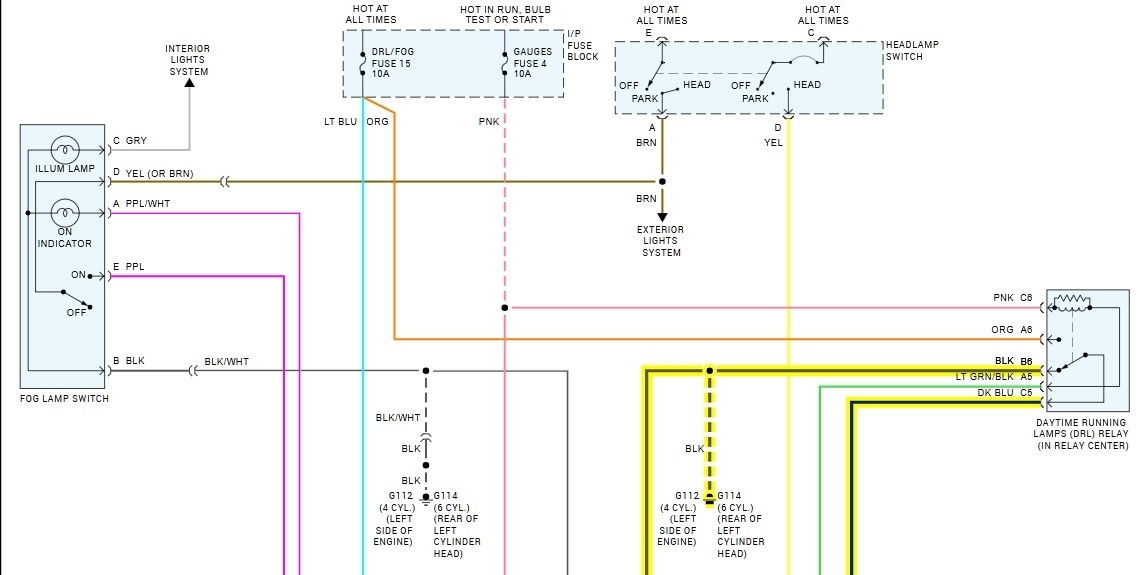

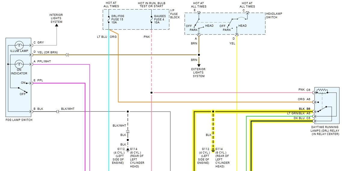

Diagrams 1,2 are for the Sealed Beam headlamp bulb, diagrams 3,4 are a composite type. The circuits are pretty much the same except with the exception of the composite type uses a ground for each side headlamp, whereas the Sealed Beam shares a ground from one bulb.
I clean grounds even if they look ok. If theres any paint under a grounding location or corrosion, I make sure theres a solid ground since they are overlooked quite a bit.
Since the wires are all Black for the headlamp grounds, with the headlamps On, measure the voltage from the Black wire(s) to Battery Negative, do the same on the power side to Battery Positive. You should have a very low reading, towards 0volts.
You can do the same measurements from the engine block and body/frame to Battery Negative as well, checking for the same loss of voltage.
Its pretty simple setup, but do check the charging system, make sure it can handle the extra electrical load.

With only one ground for both headlights would explain why both lights would flicker at the same time if it is the ground wire. A composite bulb wouldn't flicker both bulbs because there are two grounds one driver side one for passenger side. I will see if I can find the headlight ground. the diagram says the right side of the radiator support G109.

Correct. One setup shares a Ground and the other has a ground per side.

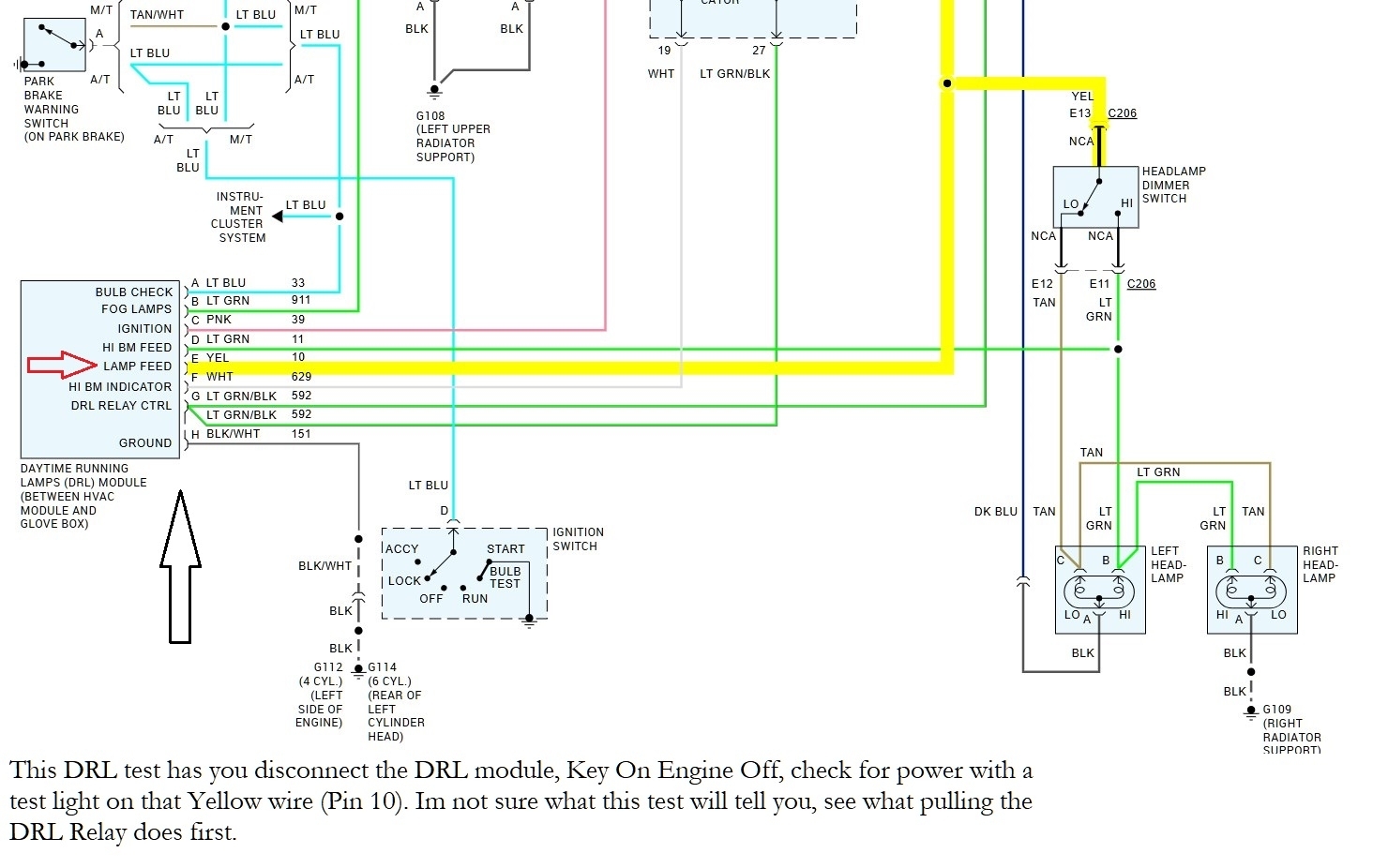

Does the flickering stop with the DRL fuse in? If it stops with the fuse in, I would leave it in. Daytime running lamps are standard on modern vehicles anyway and is not going to hurt anything.
If you want to continue testing and attempt to figure out whats causing it, see what dc voltage reading you get while the truck is running with the head lamps on High with the Red meter lead on one of the head lamp ground wires and the Black meter lead on Battery Negative. That will give you the voltage drop (or loss of voltage) on the ground side, between that head lamp connector and battery Negative. You dont want to have any voltage loss, but since you will have some, it should be a very low reading. Do this test on the power feed wire to the headlamp connector and B+ as well.
I understand this type of testing can be confusing sometimes because its the more advanced method than just reading the resistance of a wire. Resistance readings on long stretches of wire is almost pointless because the circuit is not loaded. Things change when there is a lot of current flowing. But do that test above, dont do multiple tests without knowing what the first tests results reveal. The flickering might be an issue with the route current is now taking because of that fuse being out though. Something to consider,

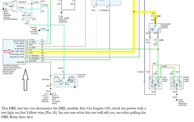

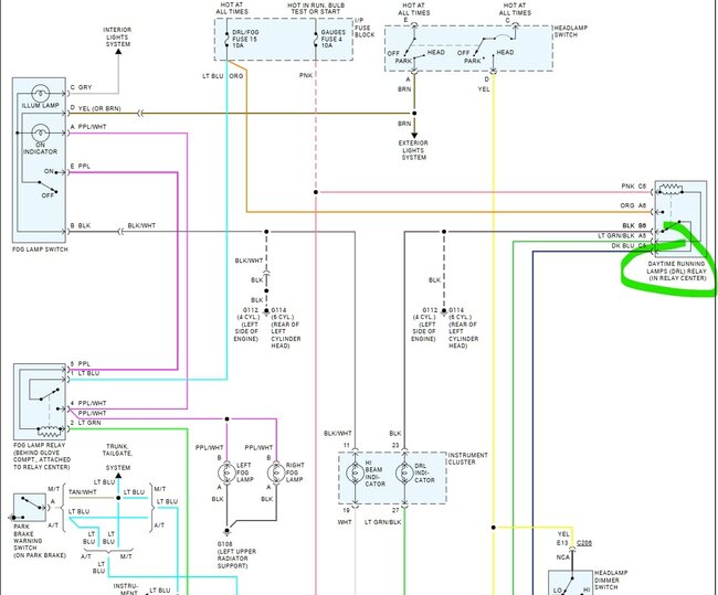

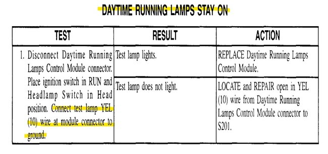

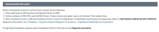

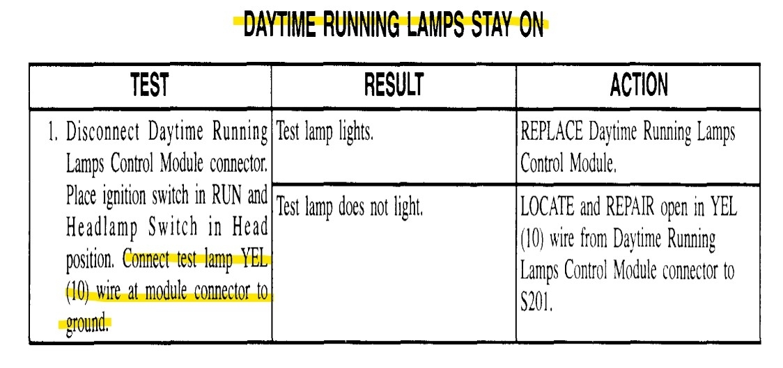

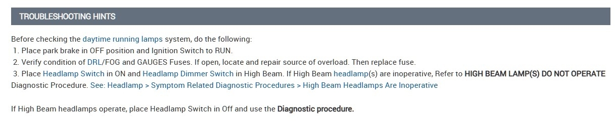

How about leaving the fuse in and just pulling the DRL Relay? Id be curious just to see how the circuit reacts, it looks like that should still work, while still providing power to the control module. Thats something you'll just have to try.
I did see some troubleshooting section too, here for the Daytime running lights staying On. Im not sure the point of this test is though.

If the flickering issue is gone for now, and you really want the DRL off, see if the relay removed acts the same way.

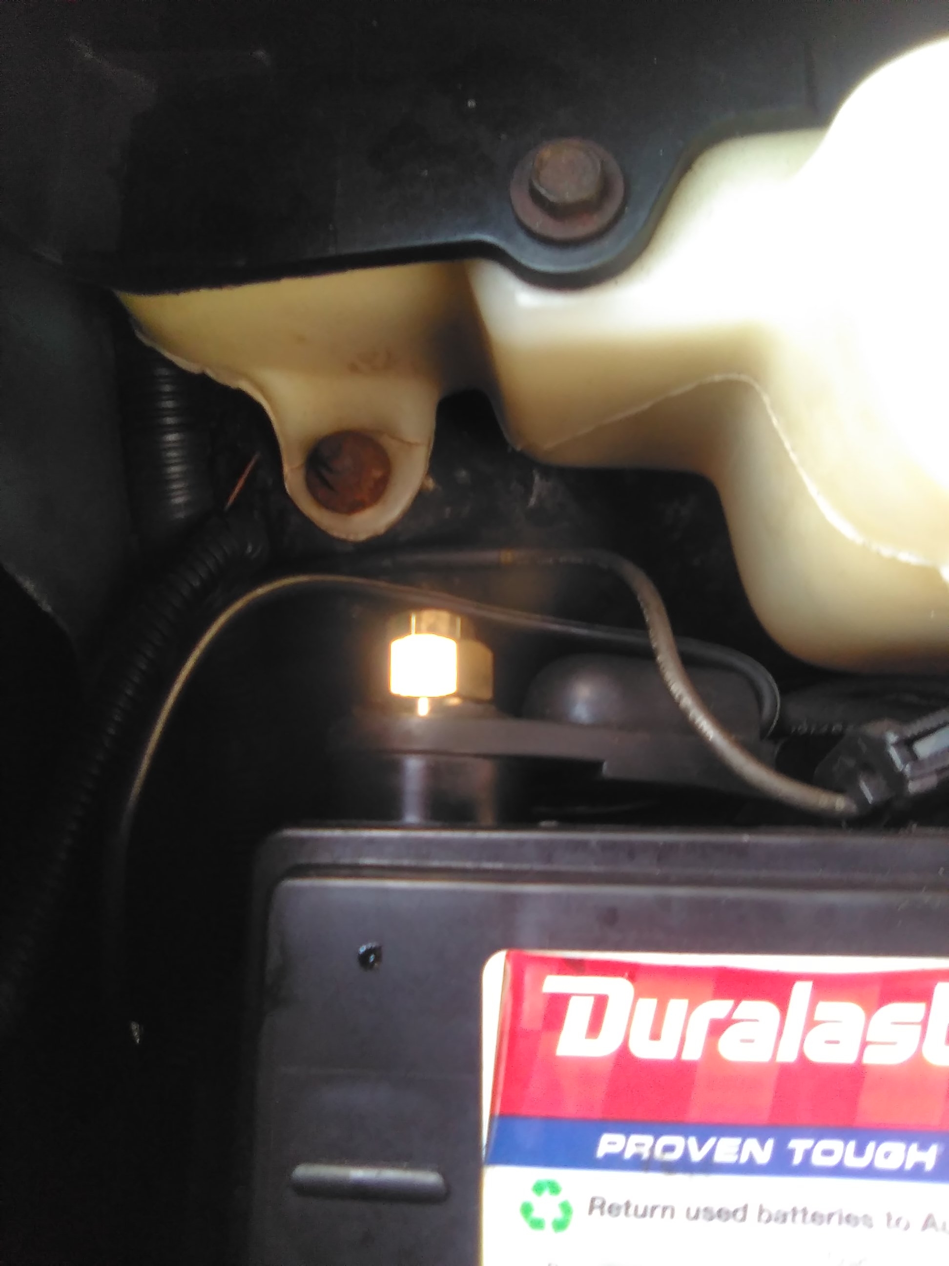

I fixed my headlights Al. Whoever bolted the battery tray in crushed a ground wire. I soldered in a new section of wire. I cleaned two ground terminals above and below the battery tray. The headlights don't flicker, they are brighter, the heater fan is faster, the turn signals are audible now and blink a little faster. With all electrical loads on in gear idling for 5 minutes I have 12.3 to 12.9 volts on my scan tool. Ign 1 wherever that reading comes from I don't know. I will check for ac voltage at the alternator post when it warms up. It's winter where I am. I am running with no DRL fuse. I don't want headlights in the daytime. I put on a gold plated battery bolt gold never corrodes or rusts.

Yeah, they look great, super bright. Grounds get neglected so much because people dont think about the return path for current. But Im glad you took the time to do the extra work with the battery and tray. It all ends up back at the battery. I am in NC. We just got slammed with over a foot of snow. The worst part is they just are not prepared here with trucks and salt. Im from up north, so I can drive fine in the snow, but this place shuts down when it snows an inch.

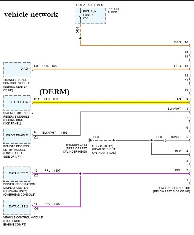

That loaded battery voltage being 12.9 is kind of borderline, but temperatures are just ridiculous right now.

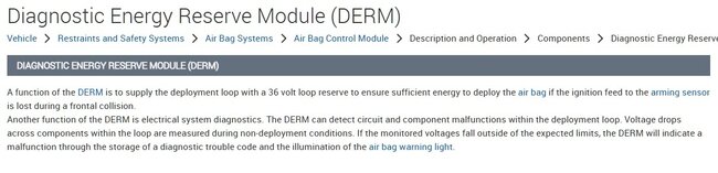

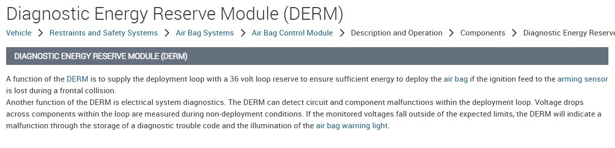

There is a power module that is reserve power (36volts) for the airbag (SRS) system and power for diagnostics. Airbags are something you probably dont want to mess with. Setting off the airbags by accident can be extremely dangerous. Manufacturers usually have a flow chart for how to check certain sections of the SRS circuits.

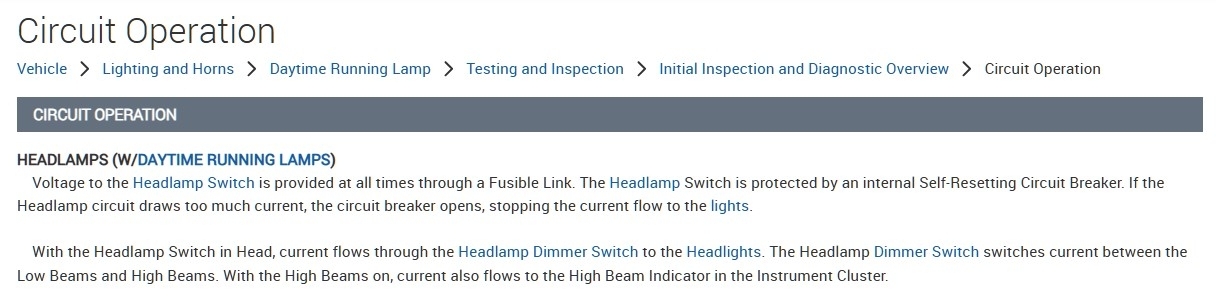

Any chance it would be a weak or failing headlight switch self-resetting internal circuit breaker?

I have seen the dimmer switch cause this issue. FYI.
