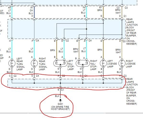

Replaced brake lamps, all back lights starts flickering. replaced the turn signal, lights are still flickering. Was told there's a bad connection between the turn signal and tail lights.

First, confirm that the correct bulb was used when replacement was done. Next, since you were moving things around when replacing the bulb, there is a chance you loosened a ground. Since all lights are affected, I suggest first checking the main ground for the lights on the spare tire hoist. See the picture I attached.
The reason I am suggesting this is because all of the lights have the same symptoms. That indicates it is one thing causing all of them to act up. The one common thing all the lights have is a common ground. I circled the ground at the bottom of the picture.

Thank you very much, it was the ground connection. Wish I came here to 2CarPros before seeing a certified electrical car specialist from a certain busy.. having us replace the multi-function signal switch. Which didn't solve the problem.

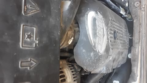

Problems still exist and now without warning the check engine oil pressure light came on while driving and new sounds came from the truck. Knocking/clunking noises. Took it to the shop next day, without really checking the truck, suggested oil change with a higher oil due to mileage 304, 907. Sent us to autozone in the truck, returned oil change done, light still on, noise still there, said give it 2 days if light still on bring back and change the oil switch. Got down the street and first time every truck shuts off. Had auto zone run codes, PO305, already replaced wires, ignition coils and spark plugs. PO157, replaced all up/down weeks before. PO327 was scheduled to be replaced this weekend. Back to shop, owner said without checking truck, need new motor. Never shut off before until they changed the oil and used 10W 30 with Lucas stabilizer. Oh also, was told that the knocking sound was do to my husband putting regular Unleaded, and regularly uses premium unleaded. We at a lost. No leaks anywhere. Never was told about sending unit could be bad or the oil pump.

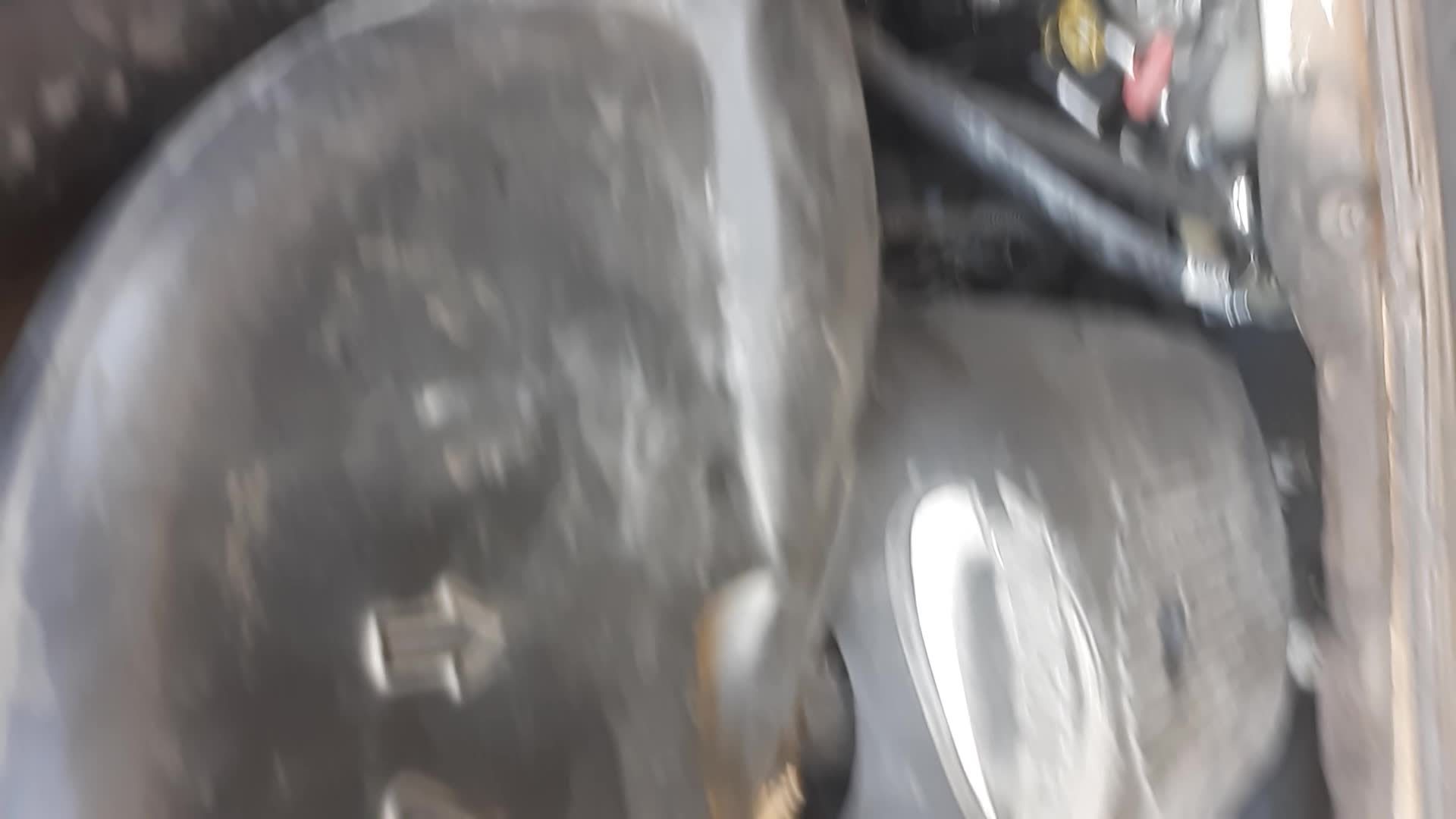

Sorry it took so long. Here's the video. Had it checked by a mobile mechanic yesterday. First said need a sending unit. Oil switch. From the quote given online. Got here inspected the truck said I need a motor. Metal shavings in the oil. I'm looking for a used motor or a rebuilt motor kit.

I listened to both videos you sent. It is making noise, but it's hard to pinpoint where it's coming from from the video. I certainly hear lifter noise. However, it doesn't sound too good.
At this point, I suggest one thing. First, don't waste the money on a new oil pressure switch. Instead, go to AutoZone and rent a mechanical oil pressure gauge. All you need to do is remove the electric on that is presently on the vehicle and screw in the mechanical gauge. Then start the engine and see what the pressure is on the gauge. Using this type of gauge basically eliminates any electrical concerns that can be causing the light to come on. It will identify what the pressure is and we can determine the next step.
Let me know if you need help or have questions. Once you have done this, let me know the pressures which were found.
