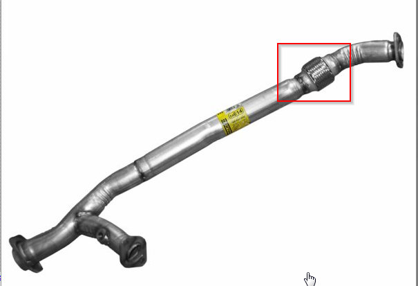

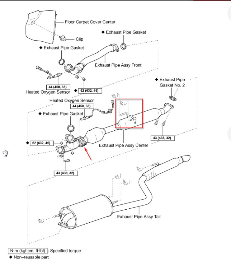

In the picture below, where would the flex pipe be?
Apr 29, 2020 at 2:37 PM
These drawings are not always exactly accurate. so here is a picture of the replacement pipe which shows the flex pipe section. Let me know if you need more info. Thanks for continuing to use 2CarPros.
