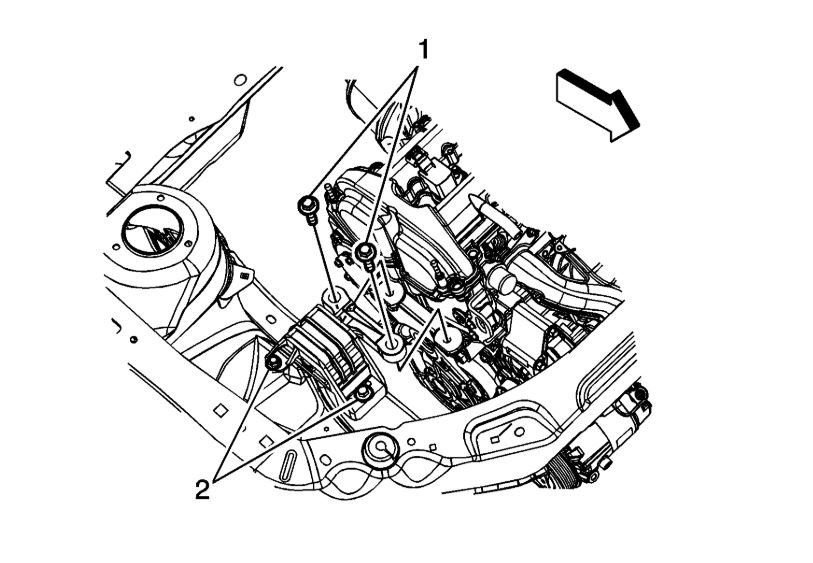

I am not sure why this keeps happening. Last time, I also replaced the motor mount hoping that this would prevent further issues. The repair shops have not indicated any underlying issues just the flex pipe. I feel like there has to be something else going on. It does not appear to be a common issue. Do you know what could be causing the flex pipe to wear out so quickly?

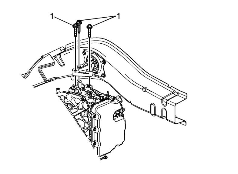

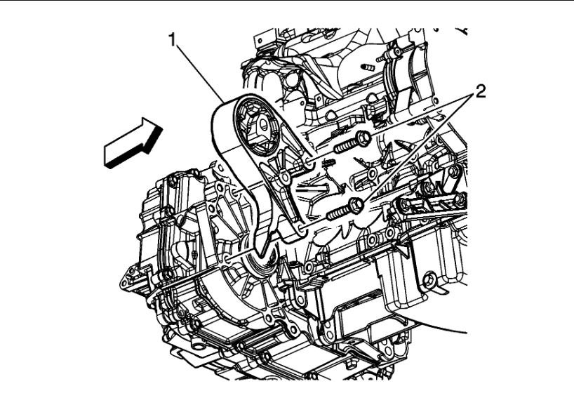

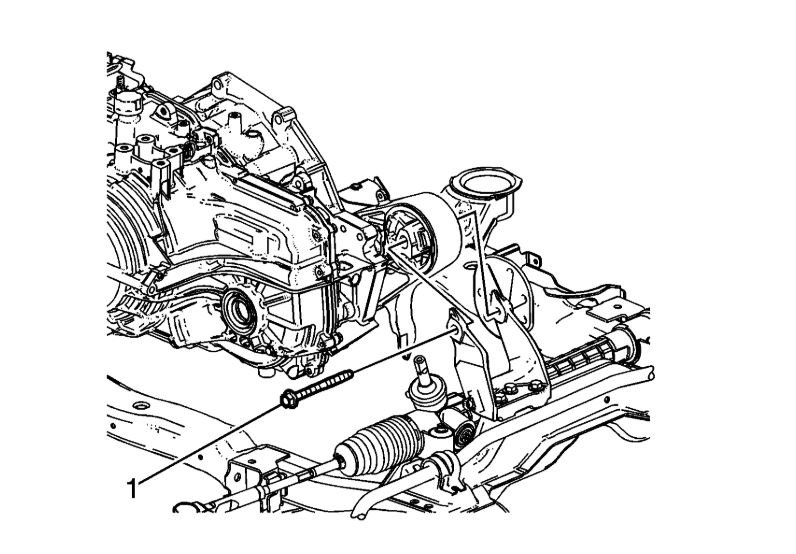

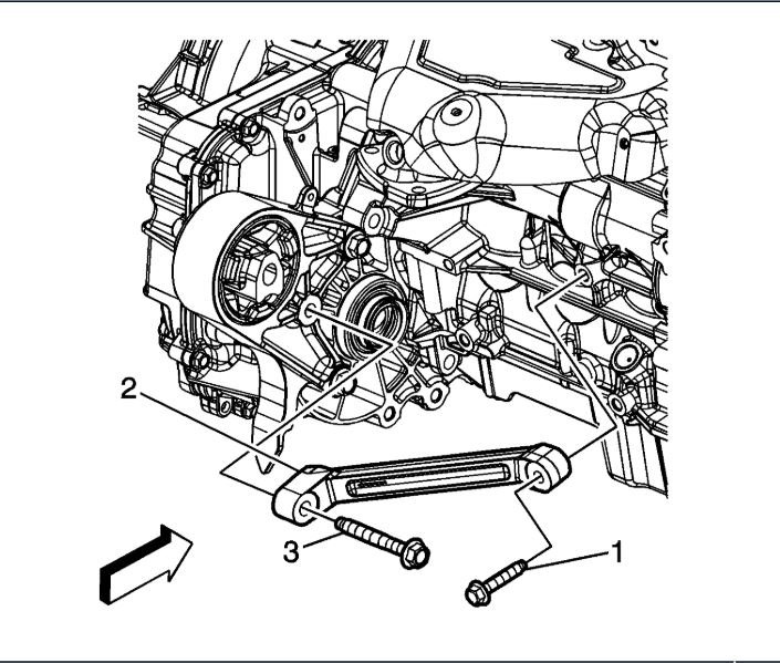

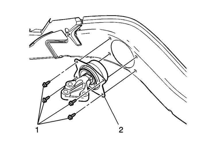

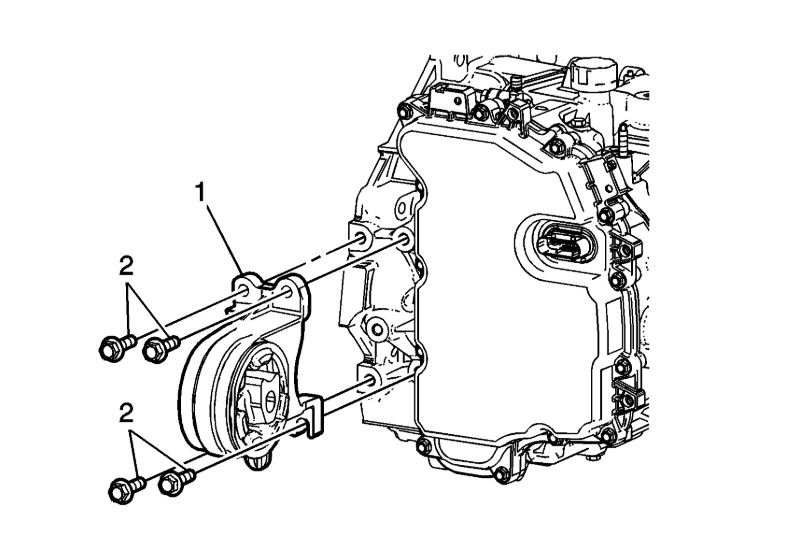

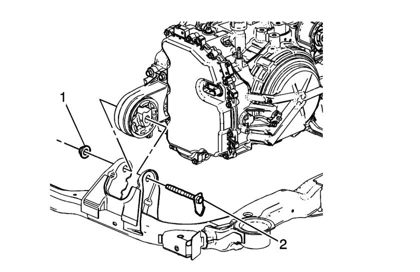

Good evening,
Just wanted to add to Alex response.
A lot of the times, those flex pipes fails from too much movement from the engine. Weak motor mounts will cause the pipe to flex way too much and it fails.
The reason for the pipe is movement of the engine. Since it sits sideways, it moves and if they did not have a flex pipe in the system, a pipe would actually fail.
Jan 30, 2020 at 11:12 AM
CHRISTINE542!
  • 5 POSTS
Thanks Roy. Last time, I did have the motor mount replaced with the flex pipe. This is why I was so surprised this happened again so quickly. It hasn’t even been 1.5 year this time.
Jan 31, 2020 at 1:53 AM
There are several motor mounts on the engine. You have 3 mounts on the transmission and 1 one the engine. Any one of them with too much play can cause this issue.
Jan 31, 2020 at 2:19 AM
