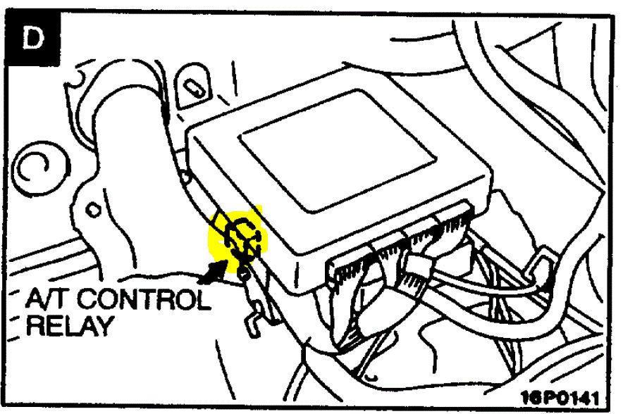

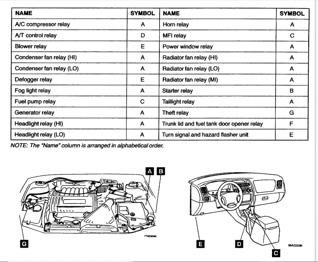

Neutral indicator flashes, code told me that the A/T control relay, where is it located?
Feb 13, 2022 at 5:13 AM
Experienced Mechanic
110,248 POSTS
The transmission control relay is tucked under the dash to the left of the glove box. I attached two pics below to help you locate it.
Let me know if you find it or if you have other questions.
