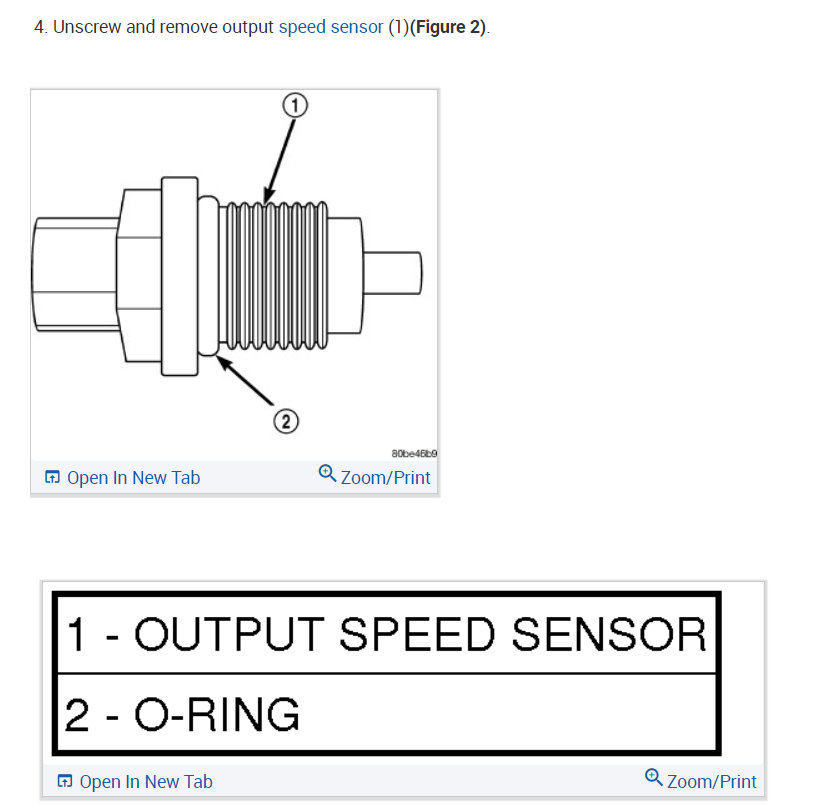

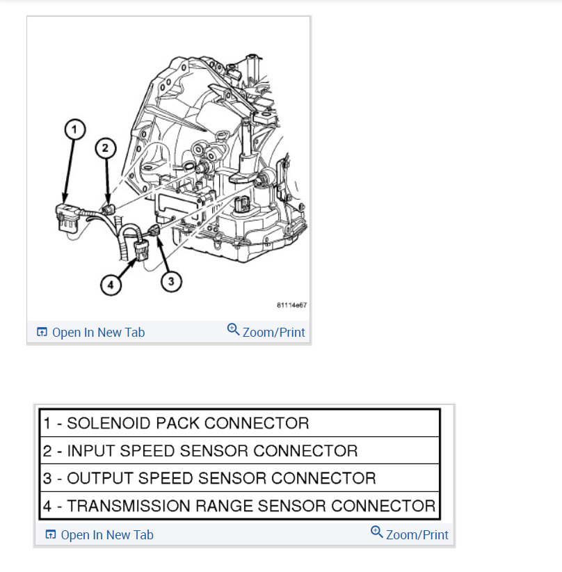

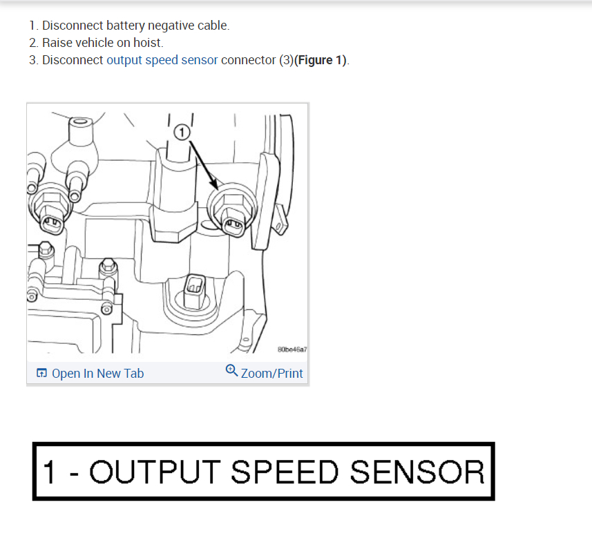

Flashing brake light, solid traction light, flashing ABS light, odometer goes back and forth from 0-60 all at the same time while driving.

Good morning,
There is a fault in the ABS system. There is a code set that must be determined and then diagnostics were done to find the failure.
https://www.2carpros.com/articles/abs-warning-light-on-easy-repair-guide
You can have a parts store read the codes for you and once we know the codes, we can assist you further.
A common failure is a speed sensor but must be confirmed. I attached the location and procedure for the sensor replacement.
