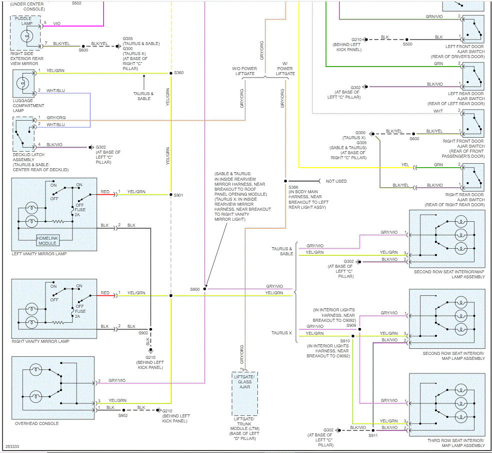

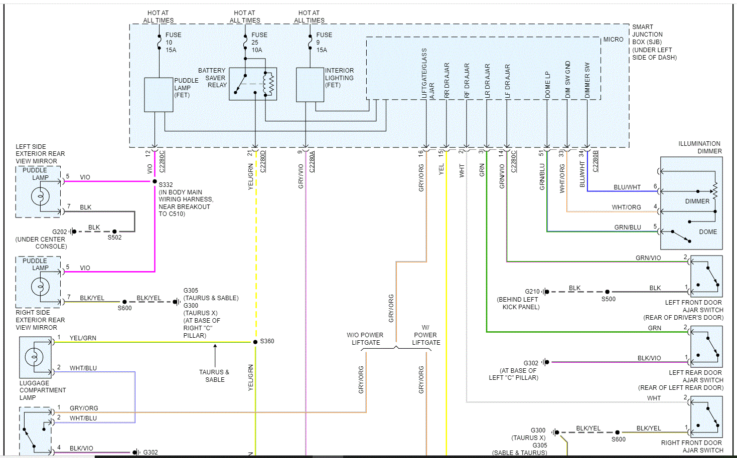

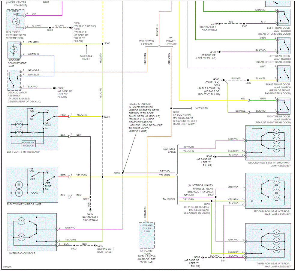

I attached the wiring schematic for the interior courtesy lighting for your reference.

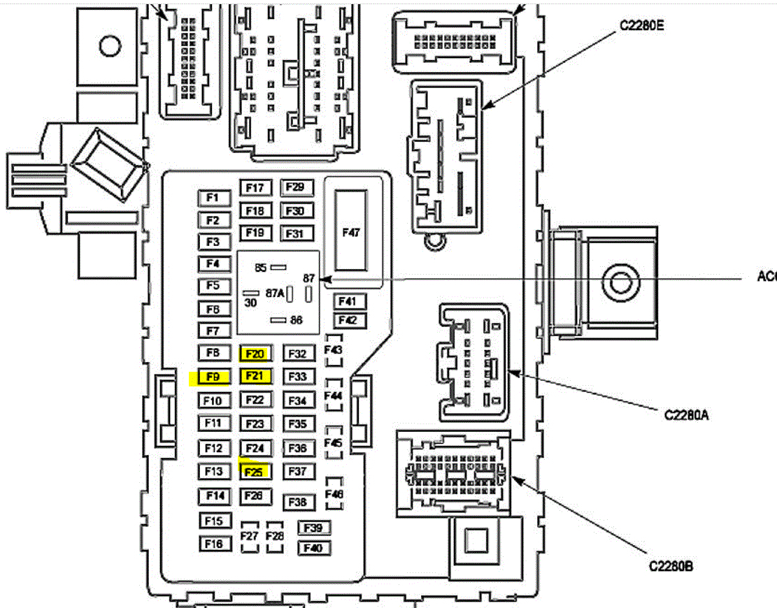

Also, check fuses in the smart junction box that I highlighted in pic 3. I have a feeling fuse 20 is blown and they were not able to communicate with the computer.

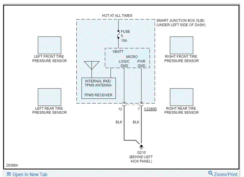

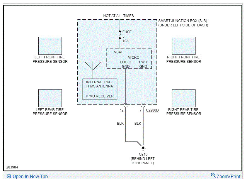

Also, note that the TPMS functionality is also contained in the same fuse box. If you look at pic 4, it shows the very basic design.
