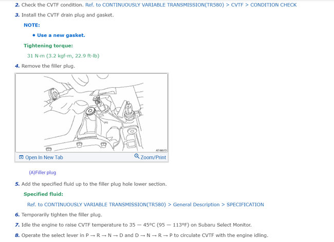

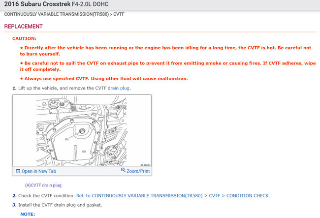

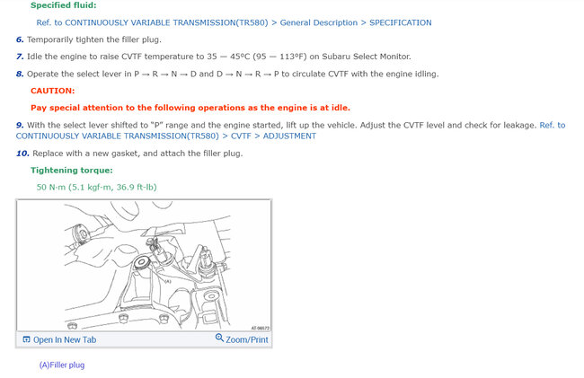

When you did the code scan was it a CAN scan? if not, this is what you need to do. You can get a CAN scanner (Controller Area Network) which will work on most cars from Amazon.
I would check the transmission fluid level.
https://youtu.be/u-4syLc-ifQ
It sounds like you have a bad transmission fluid temperature sensor, here is how to check the transmission fluid level. Also, with that many miles I would just service the transmission. Here is a generic guide to help you step by step with instructions in the diagrams below to show you how on your car:
Check out the images (below). Please let us know how it goes.
