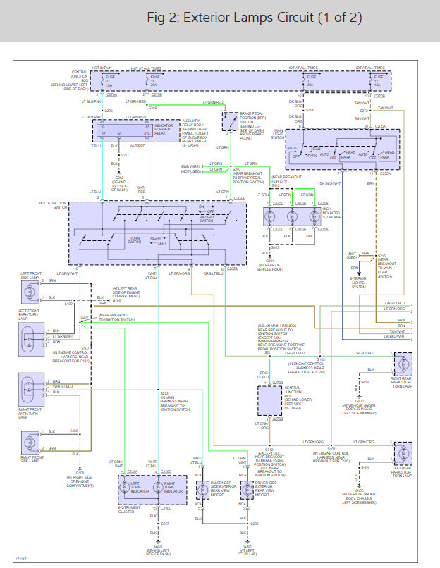

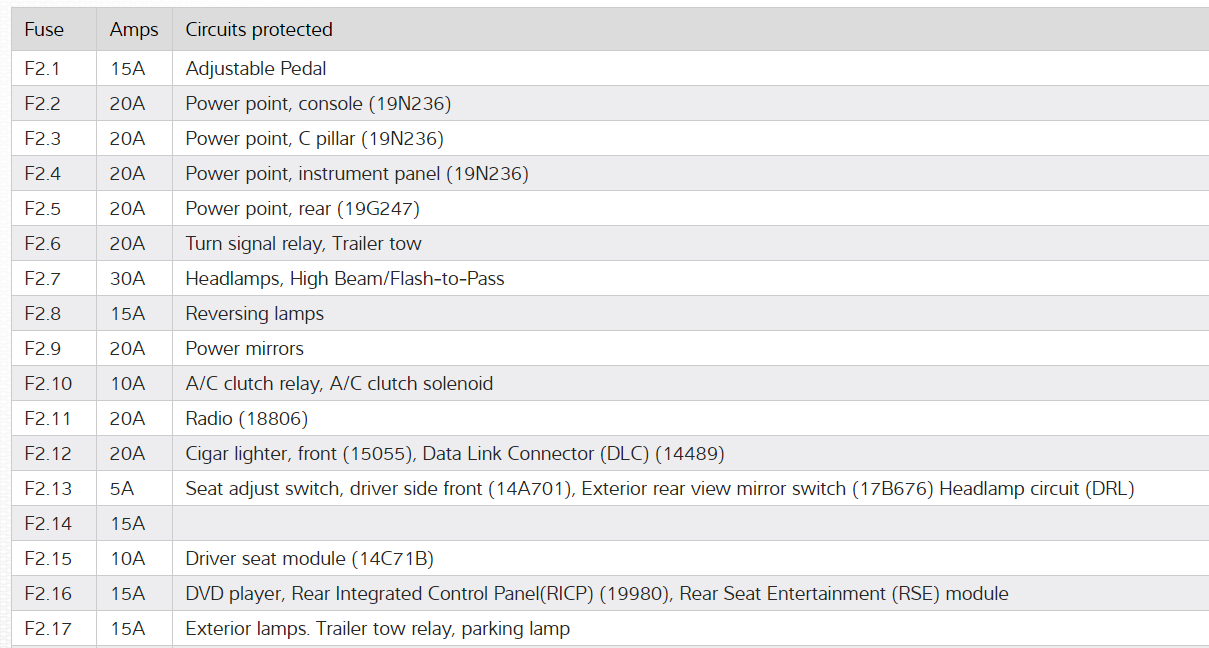

Flasher relay will not stop clicking. All lights and turn signals work properly. Replaced flasher but no change.
Jun 23, 2018 at 12:33 AM
  • 55,673 POSTS

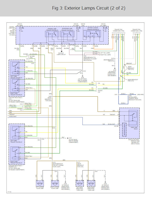

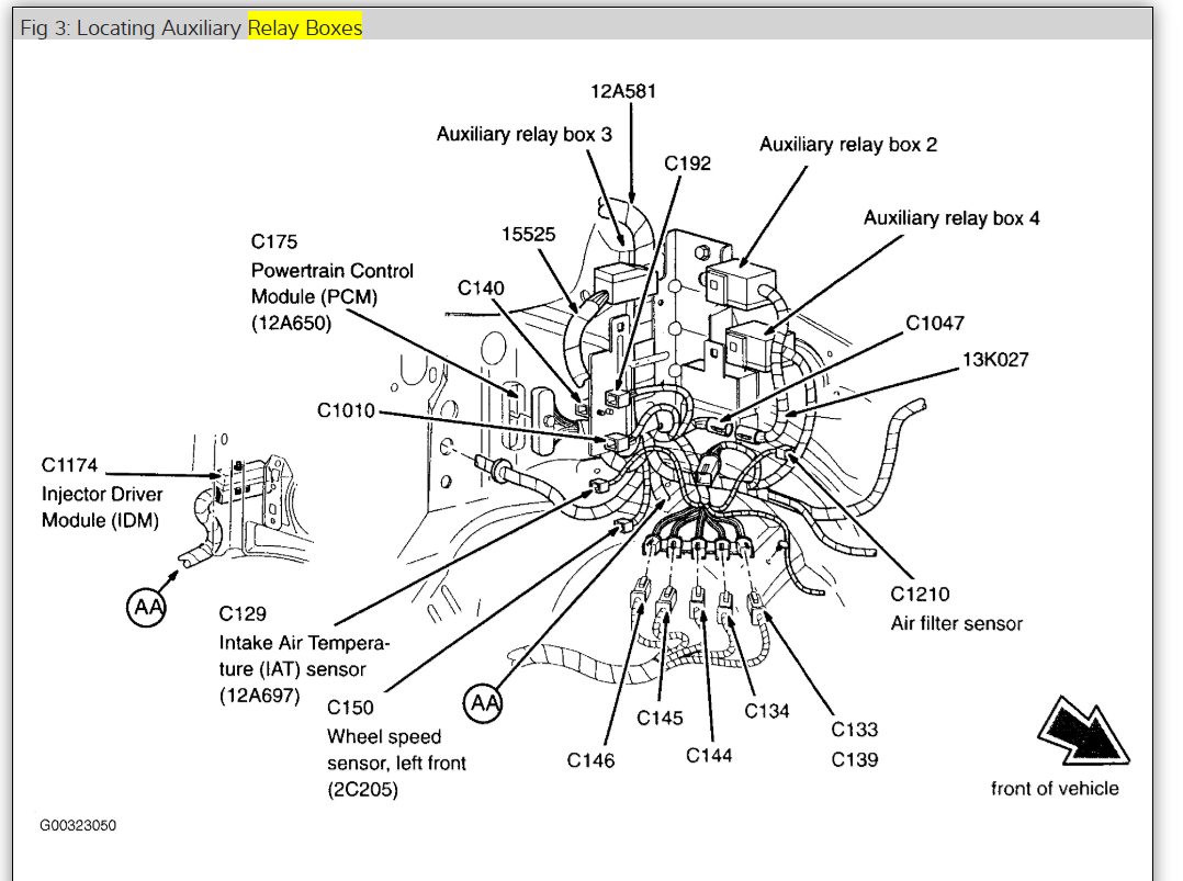

I would cycle the hazard switch many times to clean the switch contacts. Next I would remove the trailer tow relays one at a time to see if that affects it. Here is a blinker wiring diagram so you can see how the system works. Let me know if you are not on a phone and cannot enlarge the diagrams I will send larger ones.

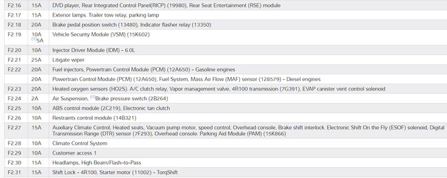

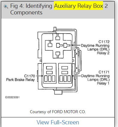

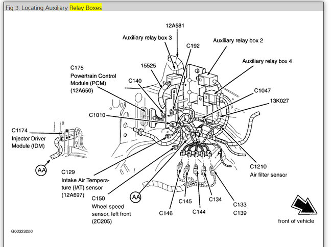

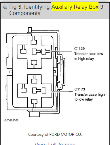

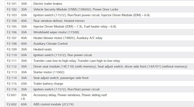

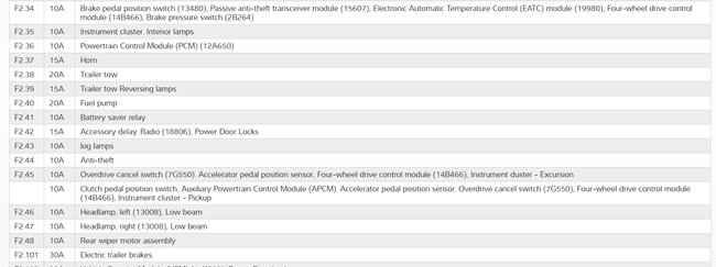

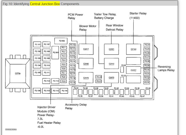

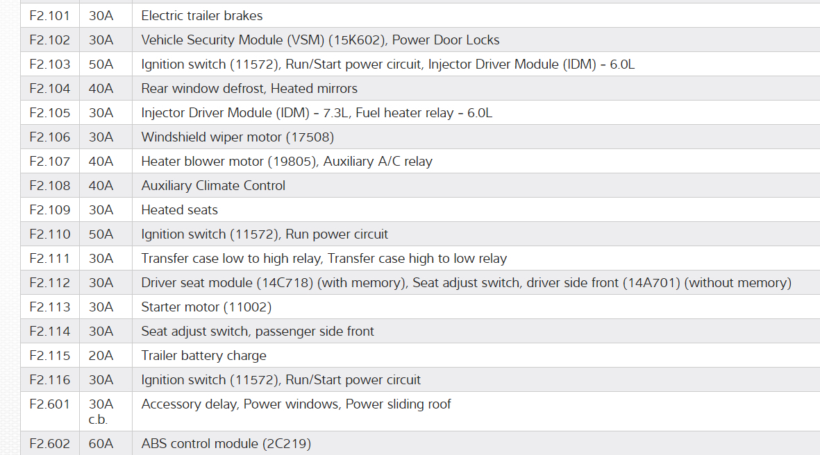

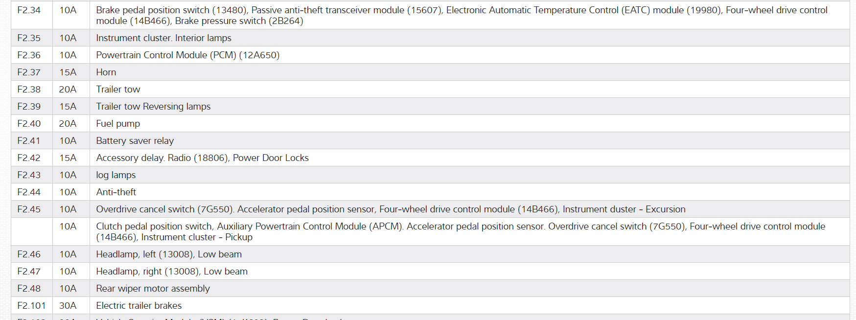

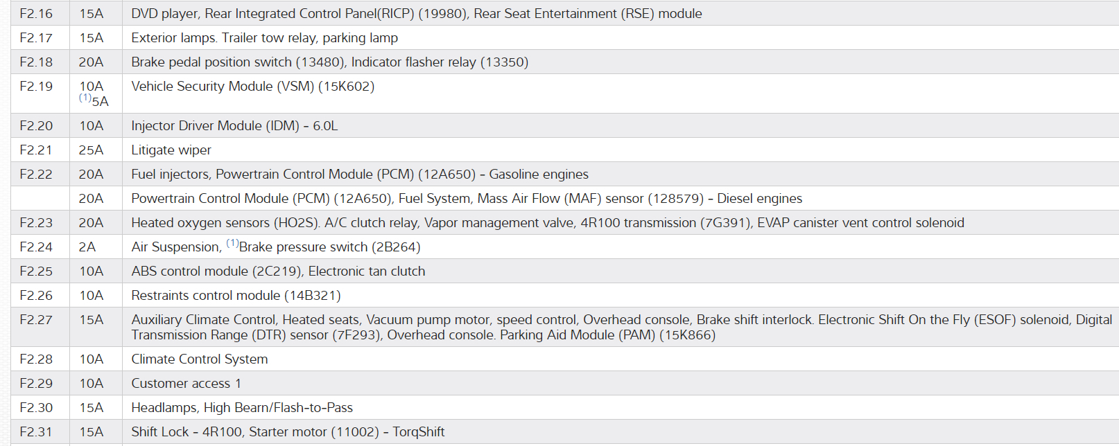

Here are the relay and fuse panel locations as well.
Jun 24, 2018 at 6:04 AM
