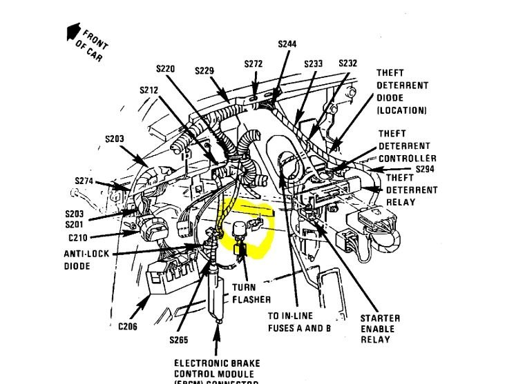

Having trouble how to get to and identify my flasher relay on my car. Brakes work fine and the left signal works except for the right signal. Any advice or information will help. Thank you.

Good afternoon,
If the left works, the flasher is good.
Do all the bulbs light up front and rear when you command right turn signal?
Mar 21, 2019 at 8:49 AM
SALLYSAL
Yes they all light up and turn on.
It also lights up just doesn’t blink or make that ticking sound.
Mar 22, 2019 at 5:55 AM
Okay, try the flasher.
Mar 22, 2019 at 5:58 AM
SALLYSAL
Would you be able help me in locating exactly where my flasher is? I’ve tried the fuse box and underneath the steering column.
Mar 22, 2019 at 6:33 AM
I circled its location in the picture I sent you in the beginning.
Turn on the side that works and feel around for the clicking.
