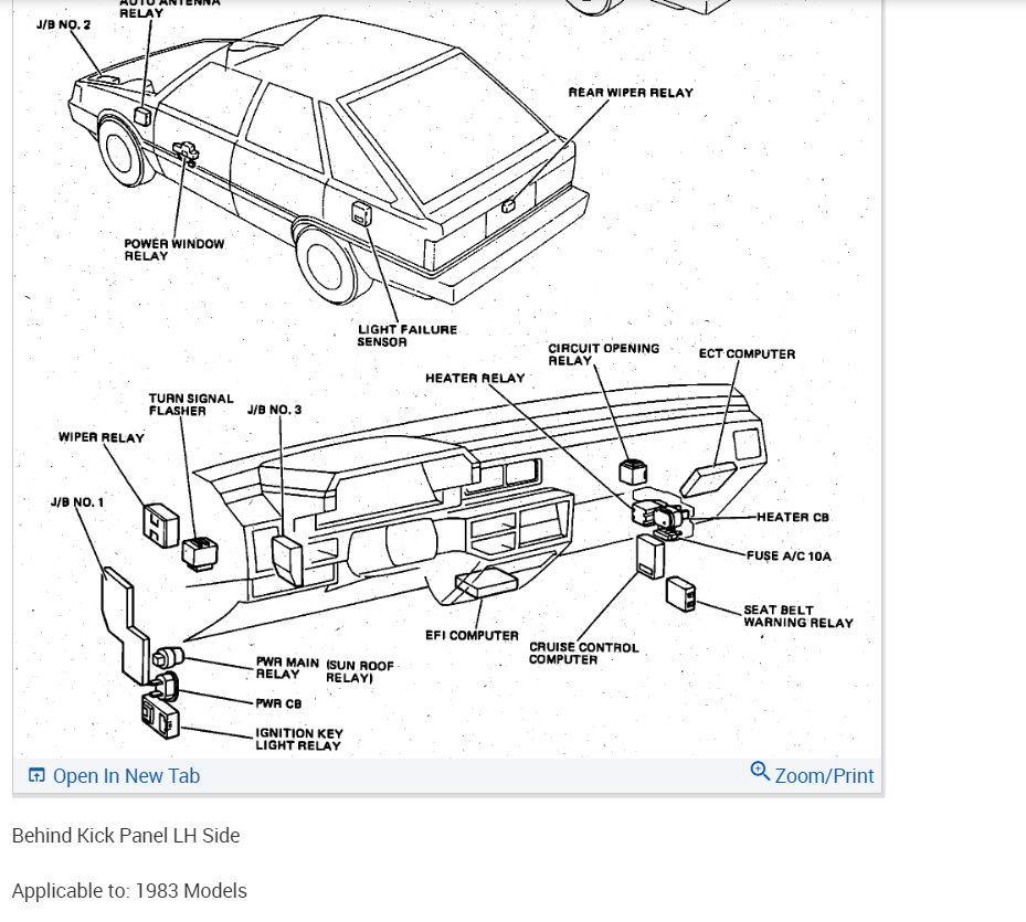

Where is the Flasher located?
1983 TOYOTA CAMRY
100,000 MILES
NELSON0998
I can't find it. Need to know the location.

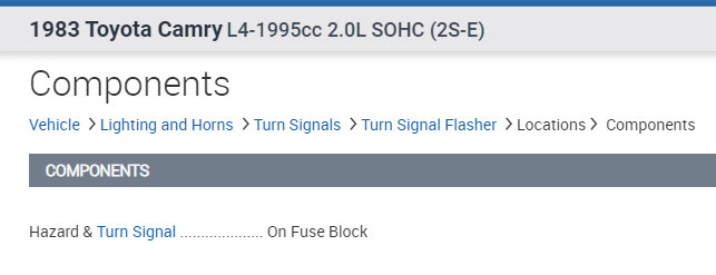

The turn signal flasher is on the fuse block in the interior, the hazard flasher is there as well.
Hazard & Turn Signal .................... On Fuse Block
This diagram should help. Check out the images (below). Please let us know if you need anything else to get the problem fixed.

Because of the model year, the information available is very limited. The only thing listed in my manual says on the fuse box. See pic below

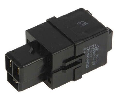

I did find the OEM part number. It is 8198016010. I attached a pic of the relay below to help locate it. Also, if you type in Toyota part number 8198016010, you will get more information.
Let me know if this helps.
