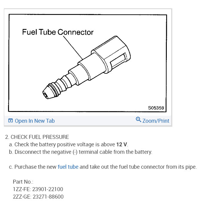

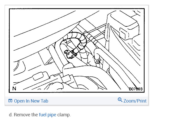

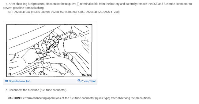

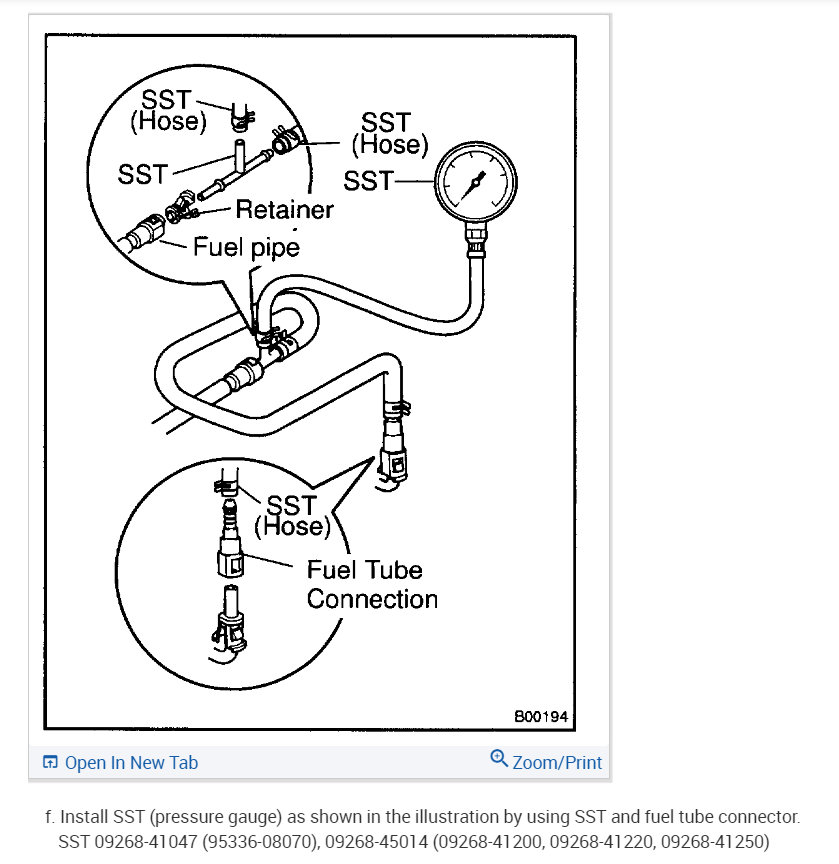

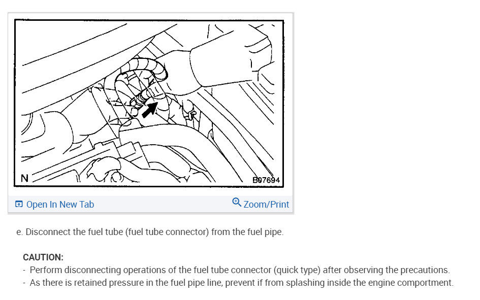

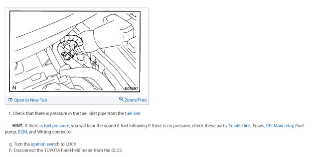

I bought a fuel pressure gauge set to test the pressure, after some research I know how to do it and what to look for, but my main question is where do I connect the gauge to my car, I know I need a fuel pressure line or such, could you please point out where it is located? maybe with a picture or diagram.

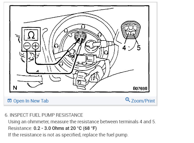

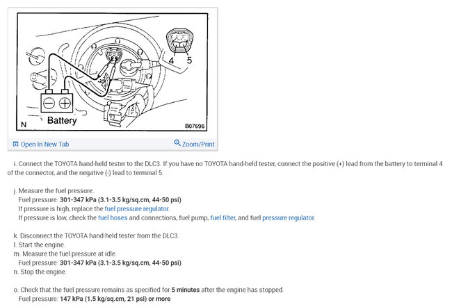

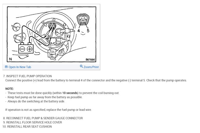

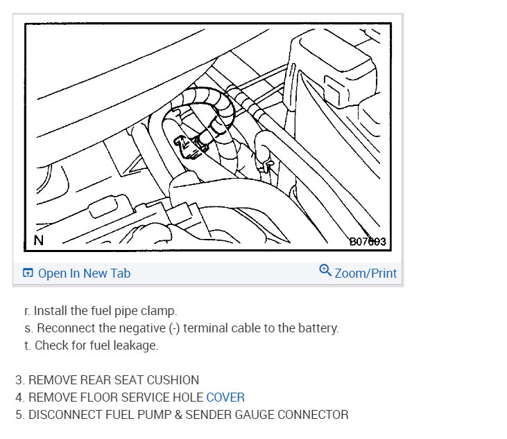

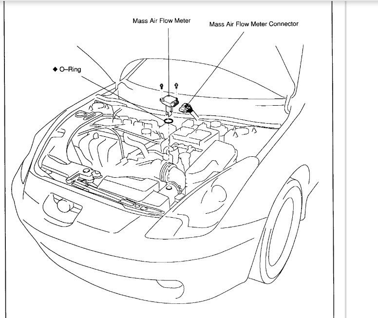

The fact that the MAF sensor was really dirty tells me the sensor is no good, cleaning will not help. I would do a fuel pressure test and if okay replace the MAF sensor. Here is how to do the fuel pressure test and I have a guide for you as well to help you see what you are in for doing the test:
Fuel Pressure - 44 to 50 PSI.
Check out the diagrams. (below) Please let us know what happens.

Thanks for providing the info and pictures above, meanwhile I replaced my MAF sensor and drove about 2,000 miles, light still hasn't turned on, so I assume its fixed. I wanted to let you know and others of course for when they have the same problem.
