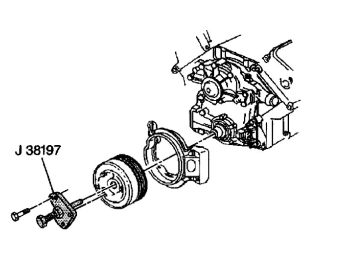

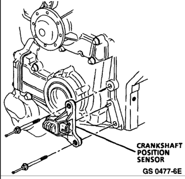

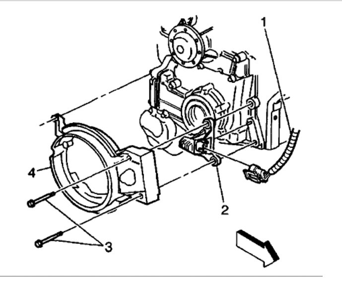

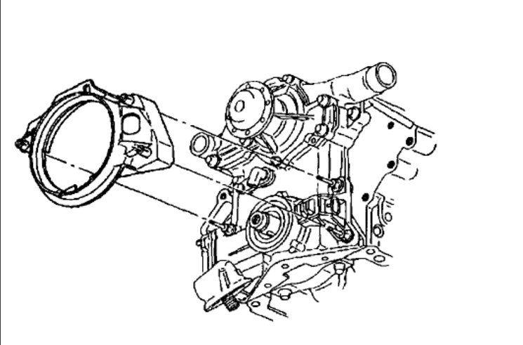

It sounds like you lost your crankshaft position sensor. The engine will run without a cam sensor but not a crankshaft sensor. Here is a guide hat will show you what you are in for when replacing the sensor:
Here is what it will be like on your car.
