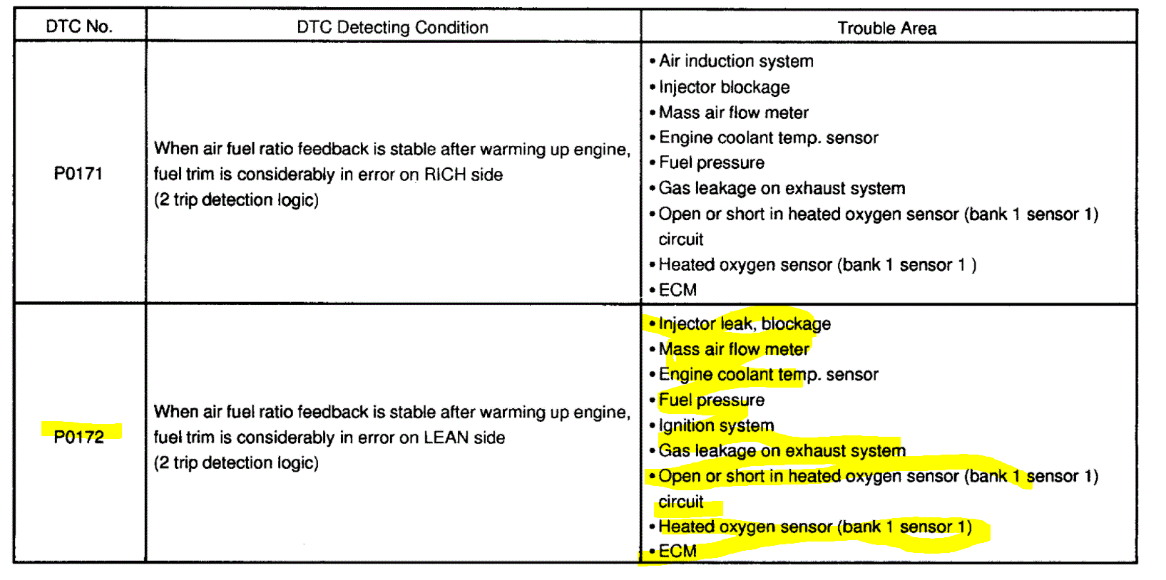

I attached a pic below showing possible causes for the code.

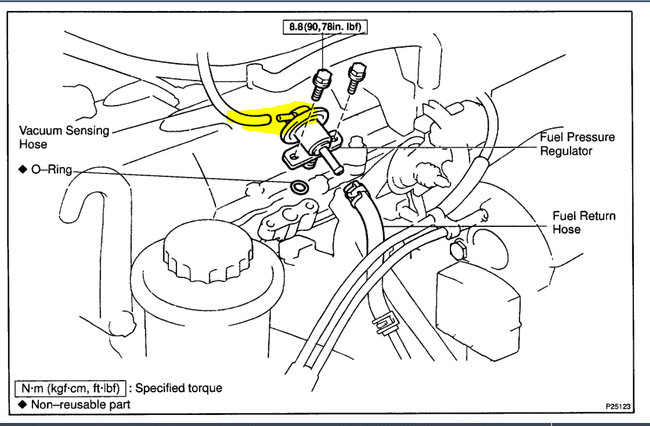

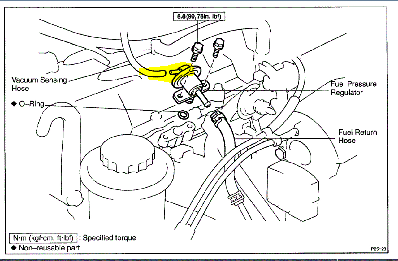

Pic 2 below shows the fuel pressure regulator. I highlighted a vacuum hose that runs to it. Remove that hose and check for evidence of gas in the vacuum hose. Also, have a helper start the engine and confirm there is vacuum to the hose.

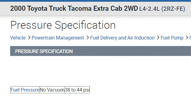

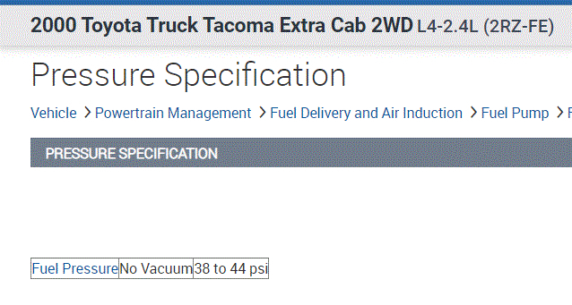

Pic 3 is the manufacturer's specifications for fuel pressure.

Did you check the vacuum line from the fuel pressure regulator? If fuel is present this is your problem. Also, please go over this guide as well.
