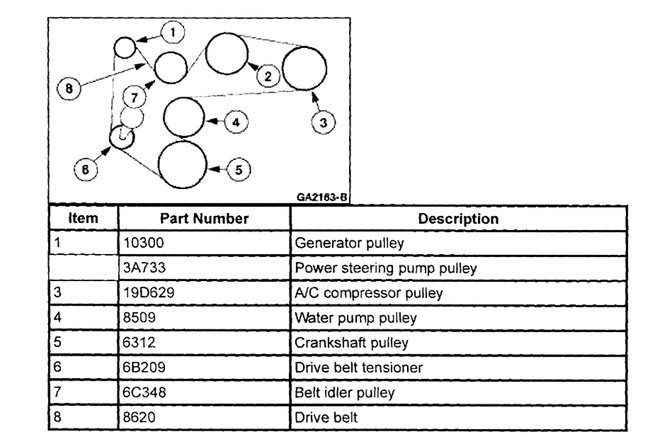

Changed serpentine belt. Then this situation started.
Then changed the battery, alternator and tensioner pulley.
I start the car up and still get an intermittent charging system dash light and power steering failure simultaneously.
Power steering fails about 3 seconds.
Belt tension is good. Battery connections are good.
Do you think harmonic balancer wear?
Any help would be greatly appreciated!
Jan 23, 2021 at 2:17 PM
  • 110,194 POSTS
I would find it odd if the harmonic balancer was an issue that started after a new belt. Since more than one thing is reacting, I feel it is related to the belt or belt tension. I realize the belt is new. Is there any belt noise that you are hearing when the failure occurs? Is the belt routed properly? (see pic 1)

Thank you for your reply. Sorry for the delay. There is no noise. Belt routed properly.
What's strange is this the symptom I had prior to putting on the new belt and it continues.
3 -5 seconds after startup it will stop and not occur while driving or idling. It will occur only on every startup. It would seem like a quick slip or pulley hanging up to a degree. At a loss. I guess it's shop time.
