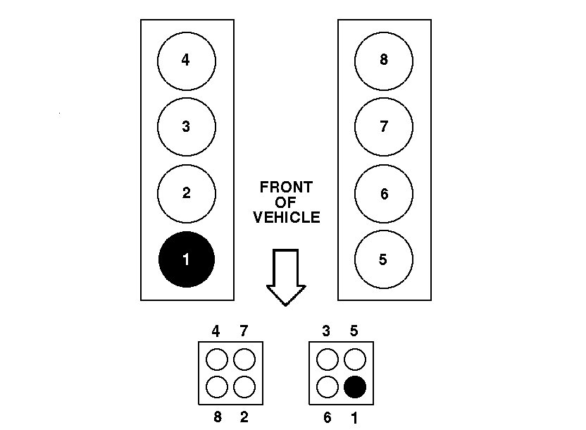

Firing order to put plugs on for packs.
Feb 6, 2018 at 7:03 AM
WRENCHTECH
  • 20,758 POSTS
Here you go.
Feb 6, 2018 at 9:28 AM
HARTIJ1
All the wires are hooked up right, but still has rough idle. did tuneup, spark plugs and two call packs, runs rough. but could still be the problem.
Feb 6, 2018 at 1:57 PM
WRENCHTECH
  • 20,758 POSTS
That is an entirely different question now. Start out reading the codes and go from there.
