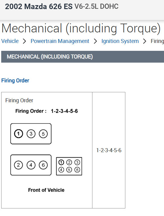

Spark plugs taken off without making note of order they go in. Please help.
Mar 6, 2025 at 3:31 PM
Experienced Mechanic
55,711 POSTS
It happens to the best of us, here is the ignition system firing order. Check out the images (below). Let us know if you need anything else.
