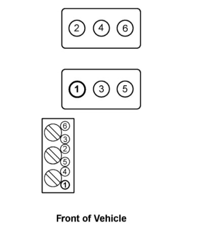

Firing order spark plug need to know the engine the order of cylinders on the engine block.

Hi Tim,
Firing order is 1-6-5-4-3-2. Diagram below shows cylinder locations, and which ignition coil fires for which cylinder (each coil fires two cylinders). Check out the diagrams (Below). Please let us know if you need anything else to get the problem fixed.
