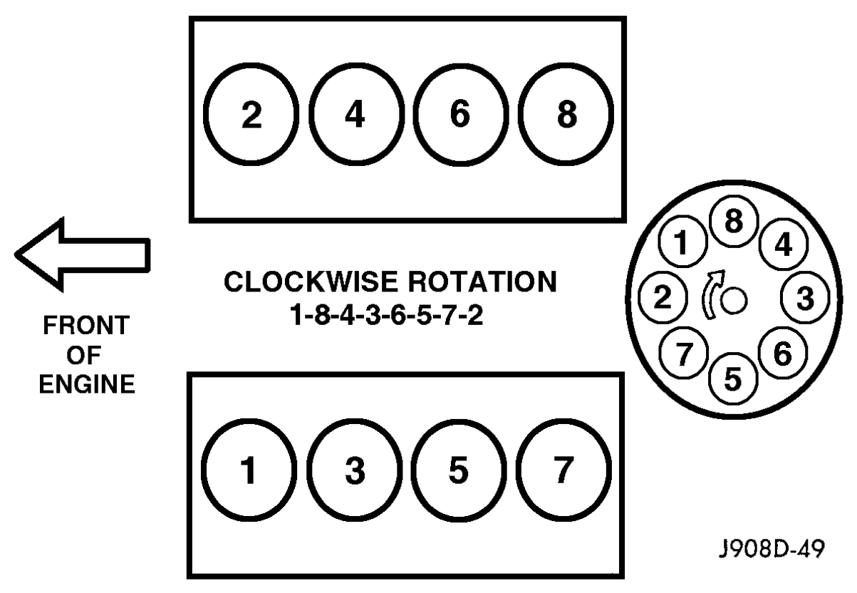

The truck listed above is a 1500 model. I bought truck with a blown motor and needing the firing order because all the wires were off already.

Sure, here is the engine firing order for a 5.9-liter Dodge engine. Check out the images (below). Please let us know if you need anything else to get the problem fixed.
