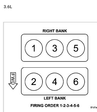

The code read p301 misfire one ignition coil and plugs. so I just need to know the firing order for my vehicle. please help.

Here is your firing order. Check out the diagrams (Below). Please let us know if you need anything else to get the problem fixed.

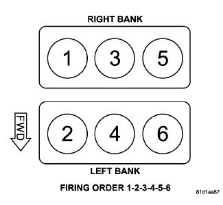

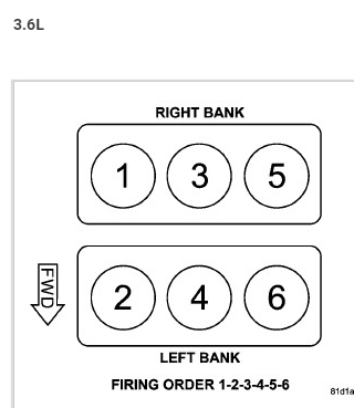

I need to know the order of my coil Packs aka cylinders.

I've attached the firing order picture below.Hope this helps and thanks for using 2CarPros.
