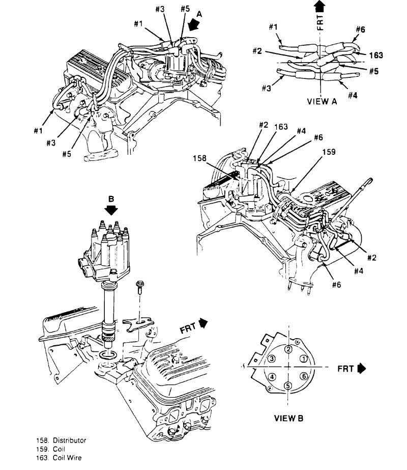

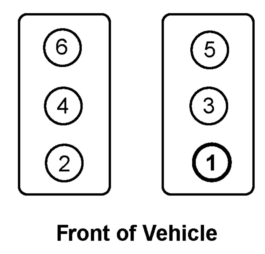

Can I please get a diagram of the firing order for my vehicle listed above?

Firing order on the 4.3 is 1-6-5-4-3-2. The attached shows the cylinder numbers and the plug wire routing for each cylinder.
