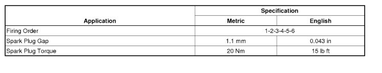

i need a firing diagram. #1 cylinder not firing correctly?

It sounds like you have a ignition coil going out but here is a guide and the firing order to help you fix it. Lets run the codes. #1 cylinder is on the furthest forward head.
Check out the diagrams (Below). Please let us know what you find.
