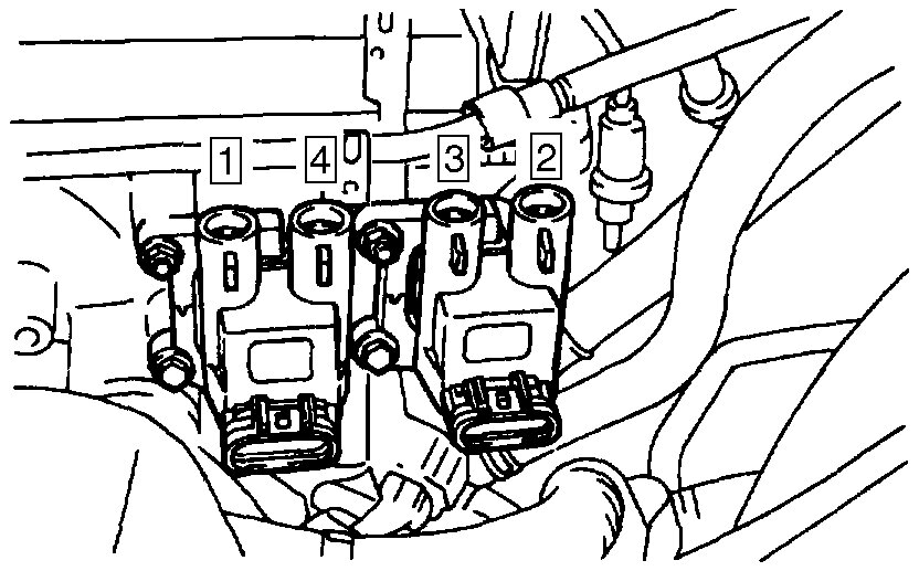

I think it's a 1.8L - unsure. Need to know correct firing order. Is it different than cylinder location order. Replacing coil packs

1, 3, 4, 2 is the firing order. See the attached image.
Image (Click to enlarge)
