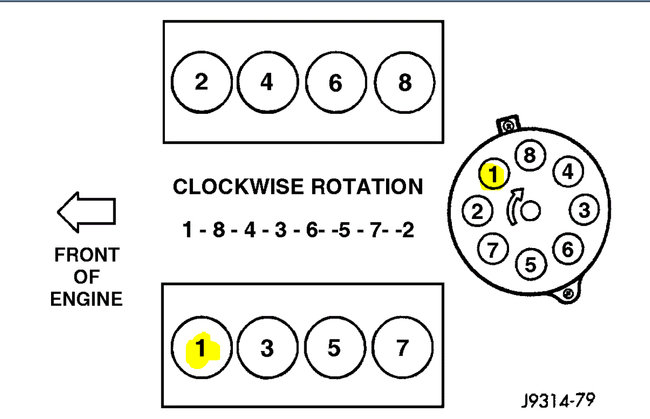

Firing order and wire routing diagram needed
2003 DODGE DURANGO
209,008 MILES • 5.9L • V8 • 2WD • AUTOMATIC
DUSTIN HENGST
I need a diagram of the plug firing order and a diagram of the wire routing for my vehicle listed above. please
Mar 26, 2022 at 6:05 PM
  • 110,194 POSTS
I attached a picture below of the distributor and the engine cylinders. Simply run the spark plug wires from the distributor cap to the plugs following the numbers indicated.
The firing order is 1 8 4 3 6 5 7 2
Let me know if this is what you need.
See pic below.
