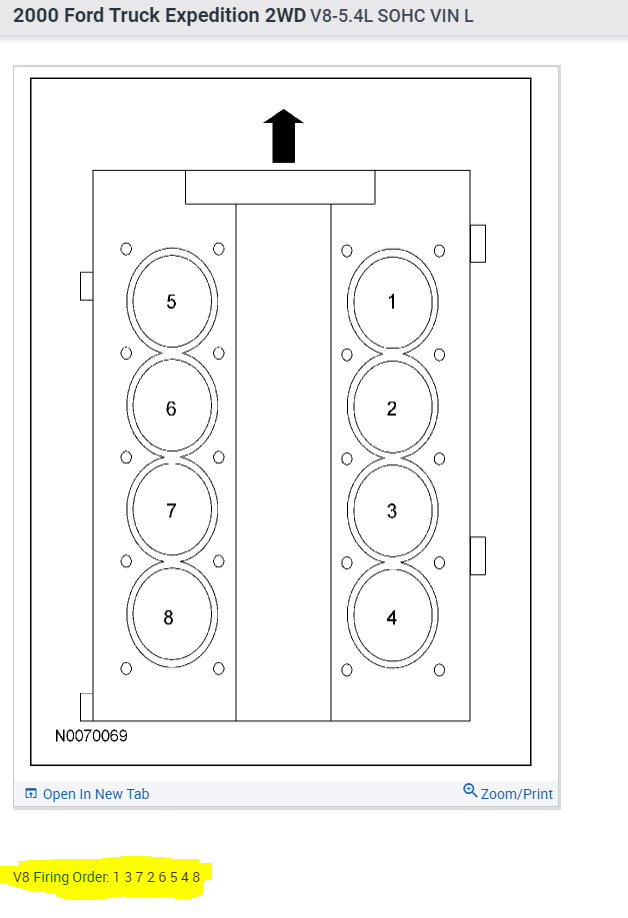

I need to know what the firing order is for this truck.

The firing order for this 5.4L is 1 3 7 2 6 5 4 8.
The number one cylinder is the front passenger side.
See attached diagram for reference.
Let me know of any questions.
