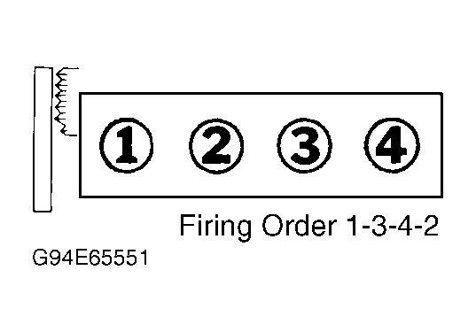

Can you send me the firing order?

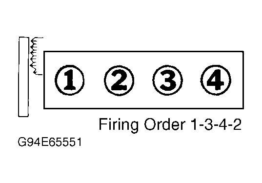

There you go that's the 2.2L engine.
