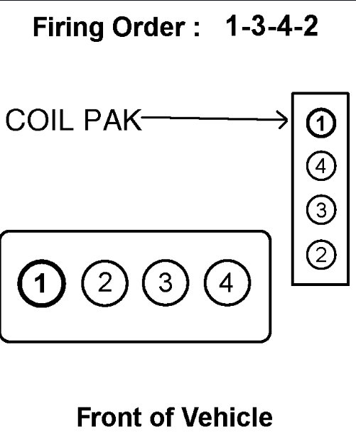

Hello, I'm Danny.
I've attached a picture below of the information you requested.Hope this helps and thanks for using 2CarPros.

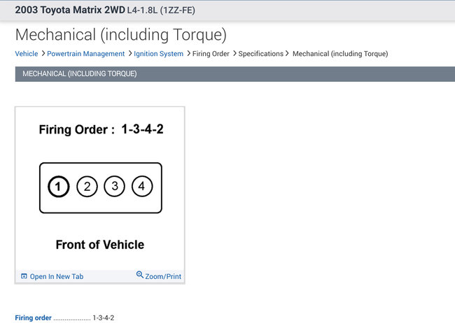

SCGRANTURISMO
  • 4,897 POSTS
I have included the information that you requested in the diagrams down below. I hope that this helps. Have a Happy New Year.
Thanks,
Alex
2CarPros
Jan 8, 2020 at 2:46 AM (Merged)
ROROBA
  • 9 POSTS
Thanks but this info is for a Toyota Matrix, my car its a Hyundai Matrix.

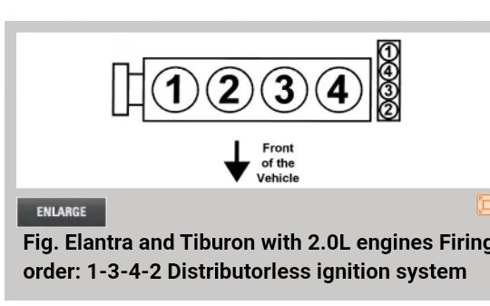

SCGRANTURISMO
  • 4,897 POSTS
Hello again,
Okay,
Unfortunately, we do not have your vehicle in our reference material. We generally only have vehicle's that are sold in the U.S. market, and a few from Canada. I looked to see if I could locate a Hyundai model with a 1.8L engine to give you that firing order, because they would be the same engine, but I can't seem to even find that in our reference guide. Usually, though, on a Hyundai 4 cylinder engine the firing order will be 1-3-4-2.
Thanks,
Alex
2CarPros

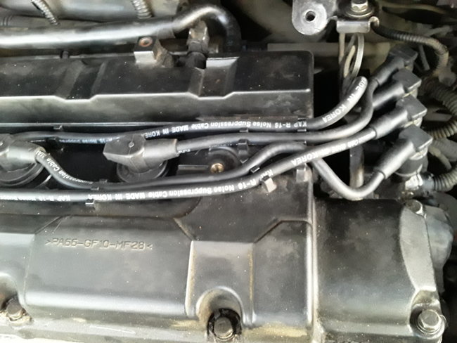

ROROBA
  • 9 POSTS
Hi Alex, thanks for you information,
This should be the correct order of spark wire?
I did confirm that you are right, firing order: 1-3-4-2.
  • 55,381 POSTS
This looks correct. Please let us know if you need anything else to get the problem fixed.

ROROBA
  • 9 POSTS
Thanks Ken!
I checked my car and cables have been with other arrangements for years! I never have get problems in starter md car.
After change the spark cable my car out more smoke with more powerful in the gases.
I buy my car in second hand, this bad cable arrangement could serve to pass the gases technical revision?
Jan 8, 2020 at 3:01 AM
  • 55,381 POSTS
How is the engine running? Can you please shoot a quick video with your phone so we can see what's going on? that would be great. You can upload it here with your response.
Jan 9, 2020 at 2:45 AM
ROROBA
  • 9 POSTS
The engine is running okay. I will upload a video later. Here I attach a pic with the old cable arrangement.
Now my car is running better despite the 200,000 km.
Jan 9, 2020 at 3:25 AM
  • 55,381 POSTS
Nice! okay if it is running good let try to have it tested to see if it passes. Please let me know.
