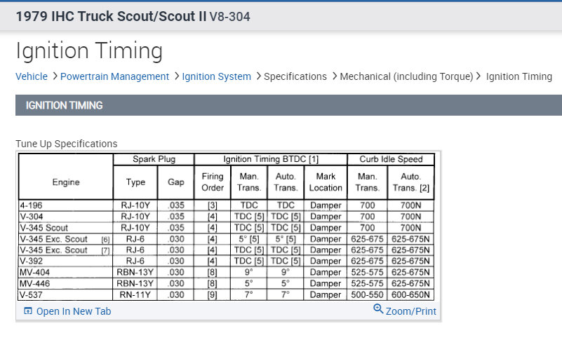

I'm not too sure what the engine size is, but I need the firing order for it. It's in a big box truck so if you could help me out, I'd appreciate it.

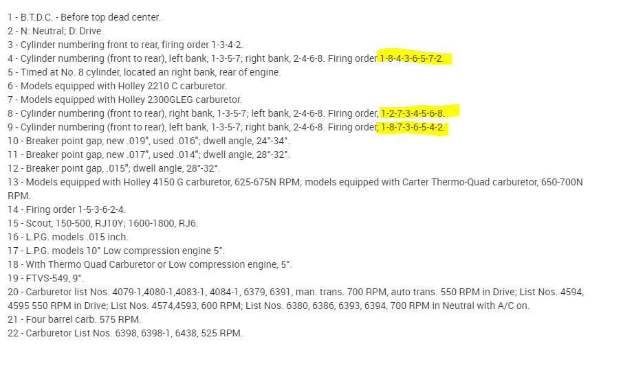

I'm not sure which engine you have, but they are different for the V8 engines.
If you look below, I attached everything I have for a 1979. The information is for a truck or Scout. It provides firing orders along with timing information.
