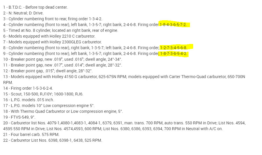

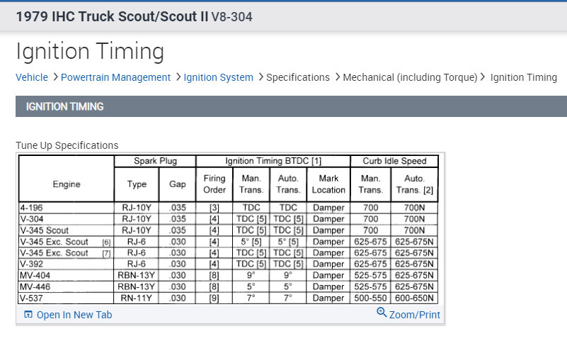

I'm not too sure what the engine size is, but I need the firing order for it. It's in a big box truck so if you could help me out, I'd appreciate it.
Dec 3, 2022 at 5:44 AM
  • 110,248 POSTS
I'm not sure which engine you have, but they are different for the V8 engines.
If you look below, I attached everything I have for a 1979. The information is for a truck or Scout. It provides firing orders along with timing information.
