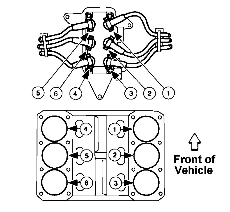

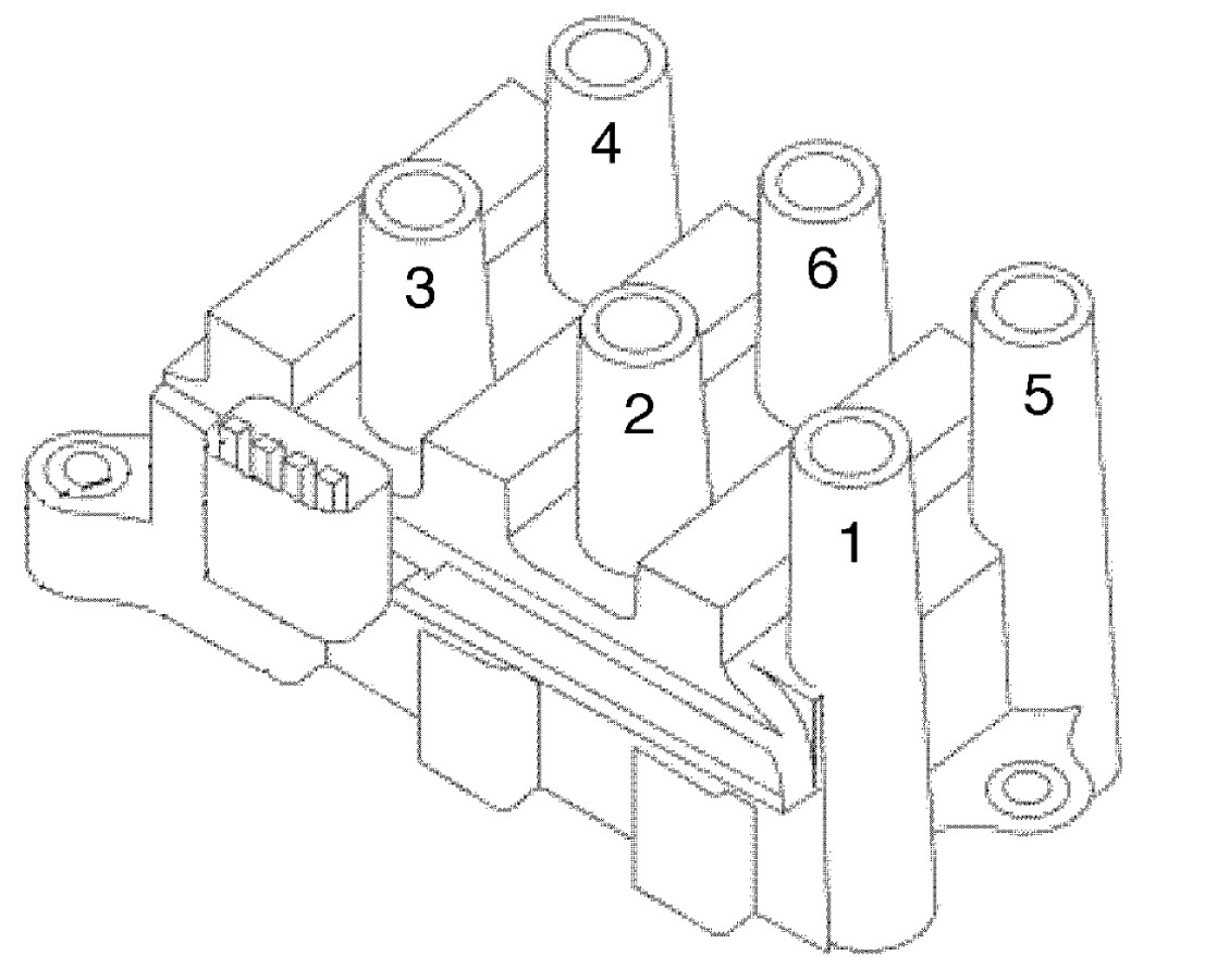

I need an exact firing order diagram coil pack and cylinder location please.

This is the pack and the way for the wires that works on that V6. Watch out for corrosion in the coils electrical connection.
