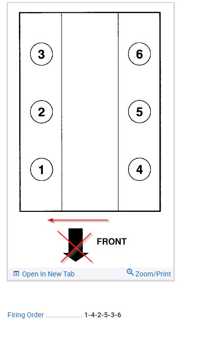

My problem is the firing order 123456 there's 3 up front close to the radiator. And 3 in back close to windshield. which 3 are the ones in front close to radiator?
Aug 30, 2020 at 11:11 AM
I attached the info but the image is not correct. The arrow is for a rear wheel drive vehicle for this engine. The arrow should be pointing to the left.
The front driver side (closest to the radiator) is number 1. Then the numbering from there is correct.
Let us know if you need more info. Thanks
