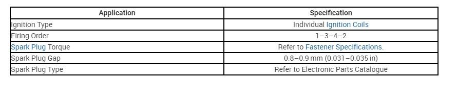

Does anyone know the firing order for the car listed above?

I attached the firing order with other specs as well. Number 1 is at the front of the engine. Check out the diagrams (Below). Please let us know if you need anything else to get the problem fixed.
