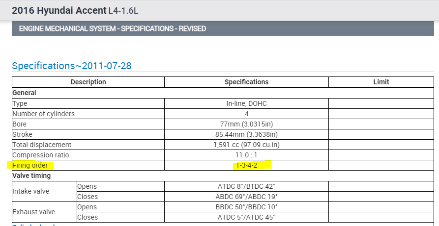

What is the firing order?
2016 HYUNDAI ACCENT
114,000 MILES • 1.5L • 4 CYL • 2WD • AUTOMATIC
MCKENZI
Need to know firing order.
Jul 19, 2022 at 6:32 AM
  • 110,241 POSTS
If you look below, I attached the requested info. As far as identifying cylinder location, cylinder one should be at the front of the engine.
See pic below.
