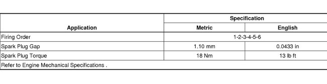

I'm looking for the firing order for my car listed above ltz.
Sep 15, 2019 at 4:05 AM
Good afternoon,
I attached the firing order for you. Check out the diagrams (Below). Please let us know if you need anything else to get the problem fixed.

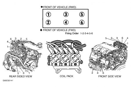

Firing order for the 3.1 liter is below. 3.1 liter engine: Firing order: 1-2-3-4-5-6. Distributor-less ignition system.
https://images.2carpros.com/forum/automotive_pictures/261618_0900c1528024baf7_1.jpg

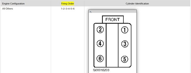

What is the firing order for a 2000 Malibu 3.1?
Sep 19, 2020 at 6:40 AM (Merged)
LSAUTO
  • 61 POSTS
the firing order is Firing order: 1-2-3-4-5-6. and the coils should have the cyl marked hope this helps lsauto

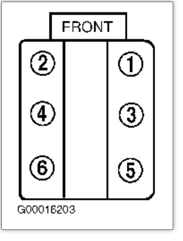

SODAJOE
1999 Chevy Malibu
what is the firing order and cyclinder placement for a 3.1 v6
RHALL77
  • 3,361 POSTS
https://images.2carpros.com/forum/automotive_pictures/166241_15977_1.jpg
cylinders 2, 4, 6 are at the front of the car 2 being at the front of the engine. 1, 3,5 are at the firewall side of the engine and 1 is starting at the front of the engine

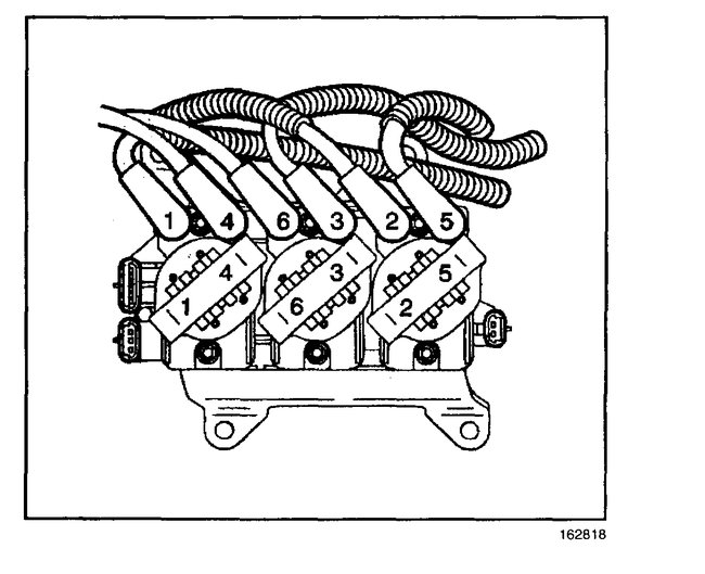

I need a diagram for firing order for coil pack and spark plugs
  • 55,710 POSTS
Here is the cylinder order as well (below) Please let us know if you need anything else to get the problem fixed.
Firing Order .................... 1-2-3-4-5-6

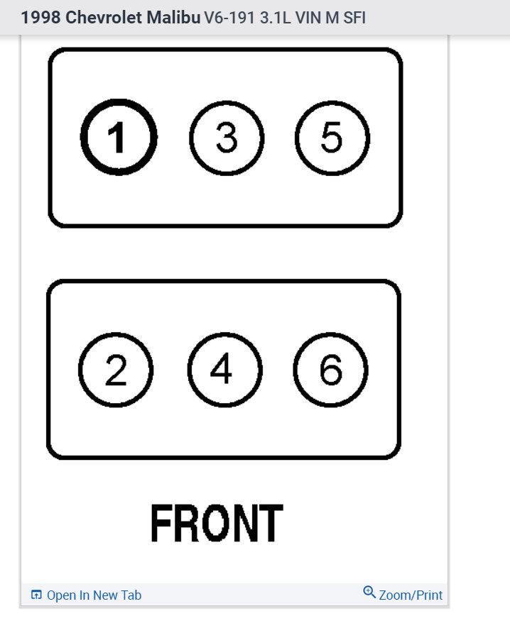

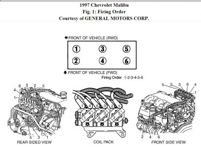

JUSTIN_19
i need a diagram on a v6 3.1 engine on a 1997 chevy malibu LS. Its that i dont know the sequence and i know im supposed to mark them but i thought i knew where they went but i sort forgot where they went so if i can know the order of it or show me a diagram
RHALL77
  • 3,361 POSTS
1,3, 5 are on the firewall side of the engine. #1 ia up front. 2,4,and 6 are on the radiator side. #2 is at the front of the engine. your module should be labeled all ready.

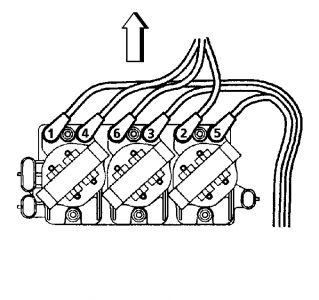

KENDRICK DENSON
1997 Chevy Malibu 6 cyl Two Wheel Drive Automatic
Put in new spark plugs and new wires but dont remember what order the wires go
Sep 28, 2020 at 3:27 AM (Merged)
SERVICE WRITER
  • 9,123 POSTS
https://images.2carpros.com/forum/automotive_pictures/30961_Wcf_1.jpg
