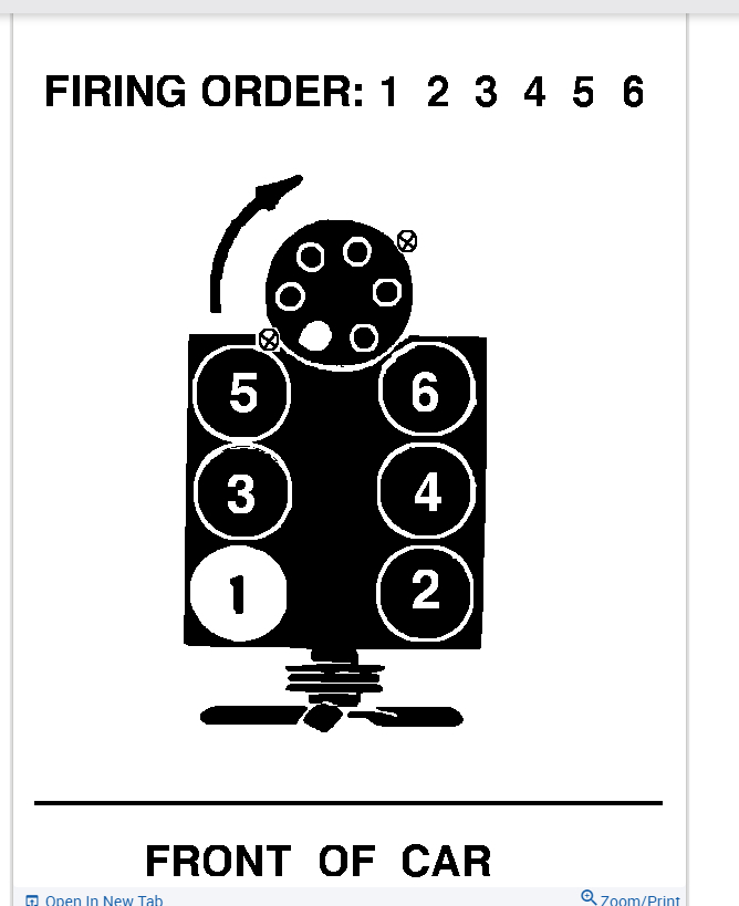

I'm trying to find the firing order for the vehicle listed above with a V6.
Sep 2, 2020 at 9:35 AM
I attached the information. Let us know if you need more info. Check out the diagrams (Below). Please let us know if you need anything else to get the problem fixed...............................................
