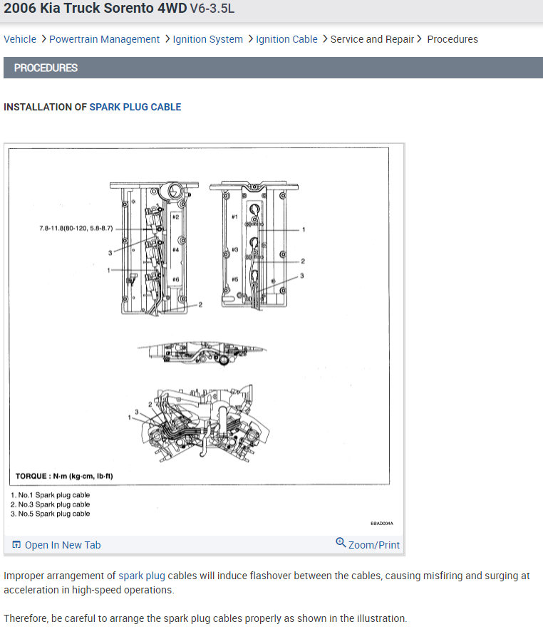

What is the firing order for my vehicle?
190,000 MILES • 3.5L • V6 • 4WD • AUTOMATIC
MNELSON088
  • 22 POSTS

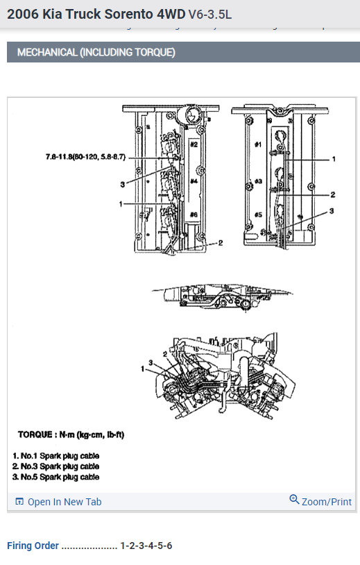

i need the firing order for my vehicle listed above (lx). I need to know where the spark plug wires go to what spark plug wire. like which ones connect from one side to the other. please and thank you
Jul 30, 2021 at 4:39 AM
SQM
  • 6,383 POSTS
Please see attached for the firing order and the ignition wires diagram.
