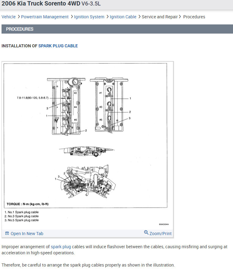

What is the firing order for my vehicle?
MNELSON088
  • 2006 KIA SORENTO
  • 3.5L
  • V6
  • 4WD
  • 190,000 MILES

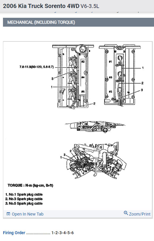

I need the firing order for my vehicle listed above (lx). I need to know where the spark plug wires go to what spark plug wire. Like which ones connect from one side to the other. Please and thank you

Please see attached for the firing order and the ignition wires diagram.
