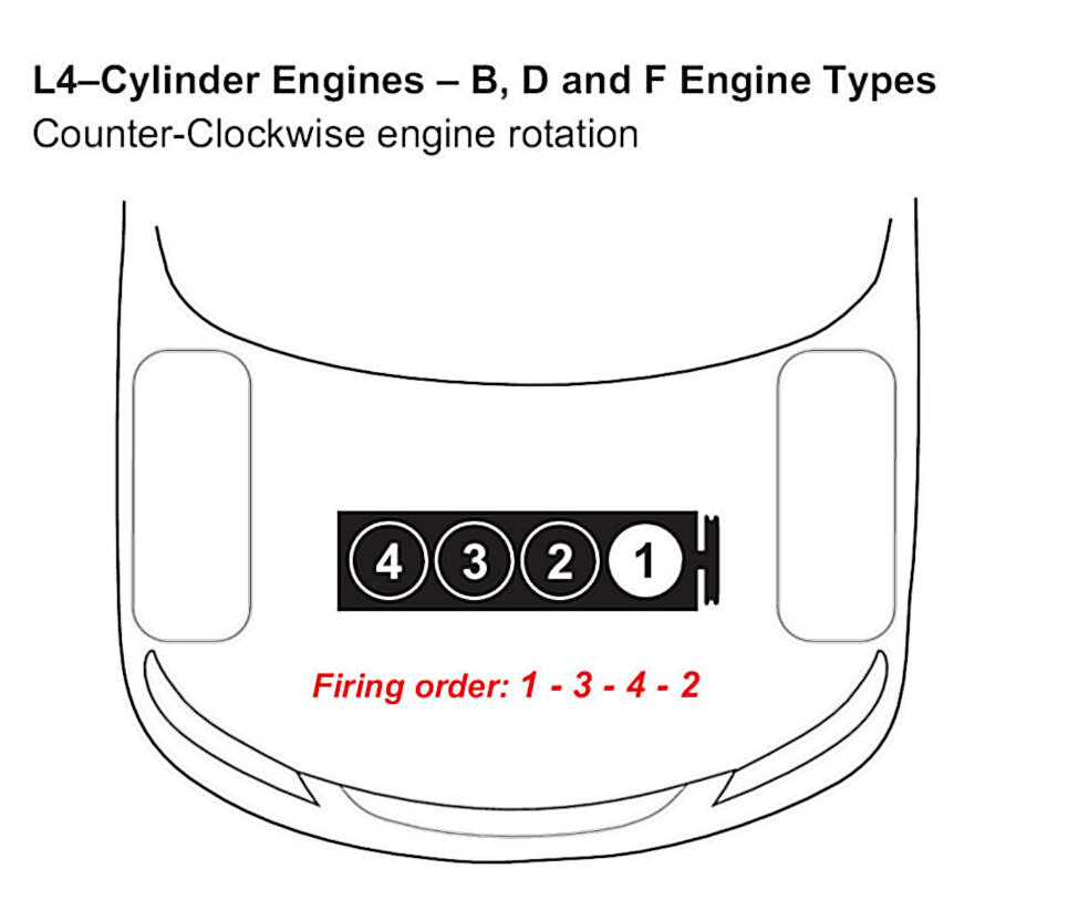

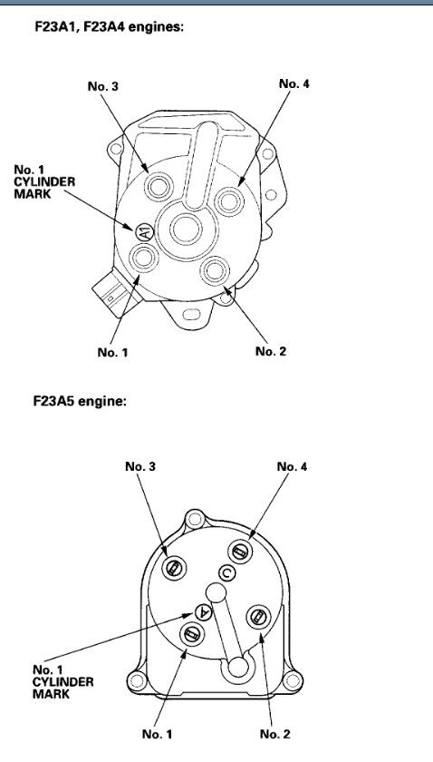

If looking at the distributor front the cars passenger side, is the number one wire on the bottom left? Then number two to the bottom right, three to the top left and following up with number 4 one the top right?
Jul 20, 2023 at 12:52 AM
  • 55,423 POSTS
Here is the firing order and how the plug wires installed onto the distributor cap. Check out the images (below). Please let us know if you need anything else to get the problem fixed.
