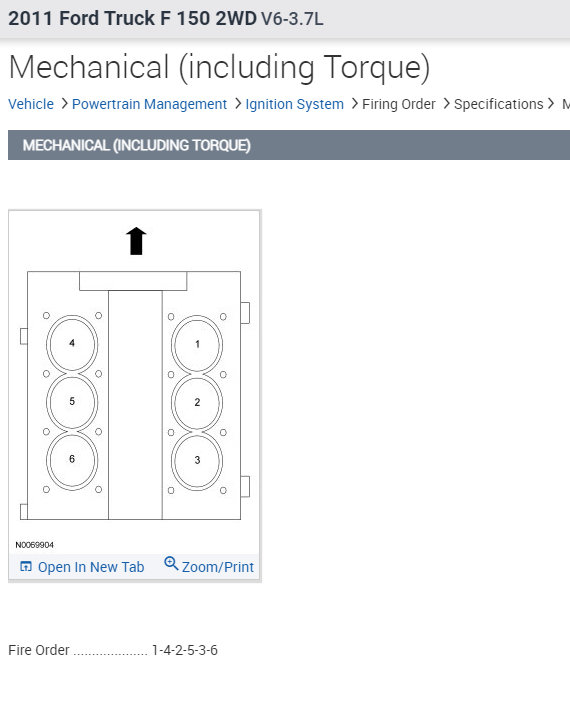

Need firing order on engine.

See attached for the firing order with diagram. Let me know if you have any questions. Thank you. Check out the images (below). Let us know if you need anything else.
