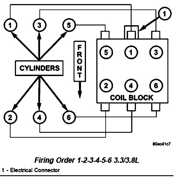

What is the firing order for a 2008 dodge caravan 3.3L?

Here it is.
