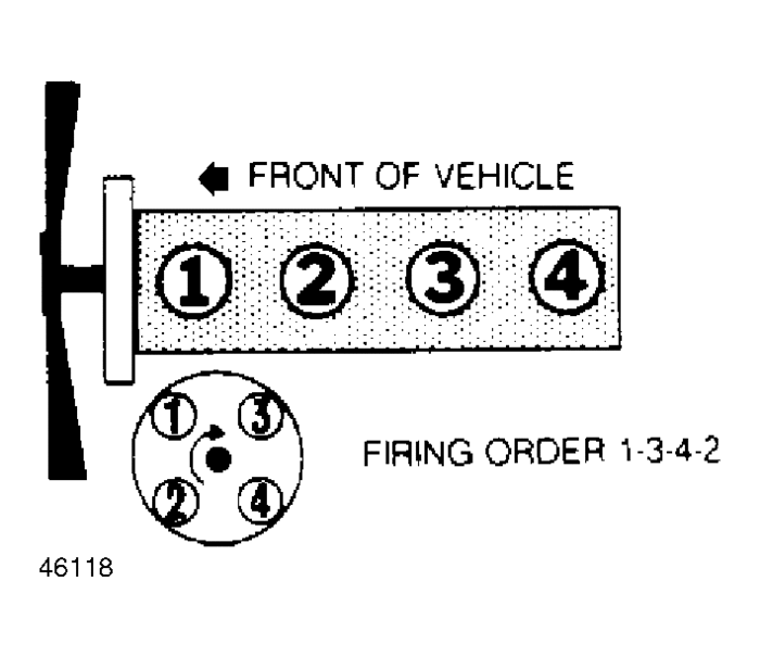

Need a diagram for firing order.

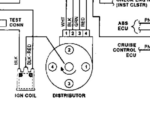

Here is the firing order for your car, see picture firing order is 1-3-4-2. Check out the diagrams (Below). Please let us know if you need anything else to get the problem fixed.

What is the firing order on a 2.4, 4 cylinder for this van?

Here is the engine spark plug firing order. Check out the diagrams (Below). Please let us know if you need anything else to get the problem fixed.
