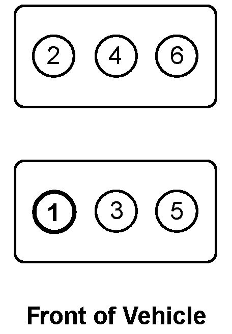

Hi guys, I just need to confirm the correct firing order. I'm not sure of the exact engine size, but it has a v6 in it. Thank you.

1-6-5-4-3-2 is the firing order for the 3.8 in that car.
Image (Click to enlarge)
