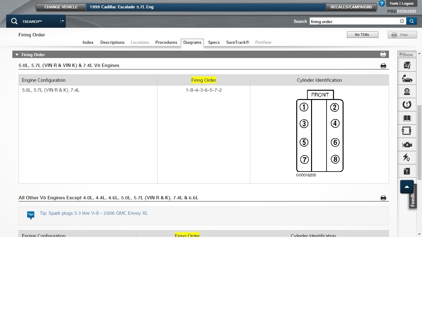

Can you send a diagram of this vehicle firing order?

Yep
