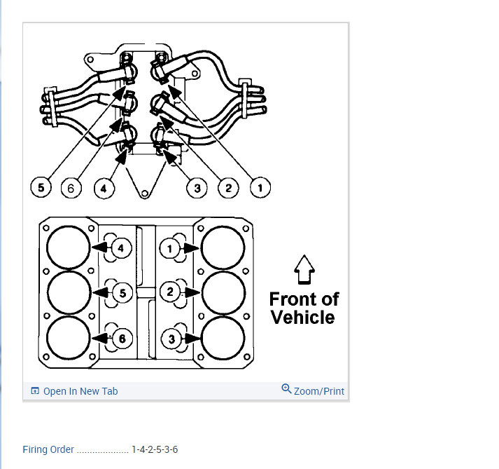

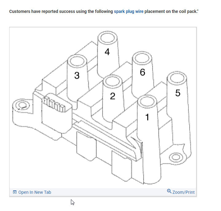

I just replaced the spark plugs and wire set and coil, and now i don't know the identification spark plug wire to coil. My van listed above is an e250 4.2l v6 spi. Can somebody help me out? Thank you!
May 17, 2021 at 2:19 PM
Take a look at the info below. This is the firing order and the placement on the coil pack.
Please let us know what other info you need. Thanks
