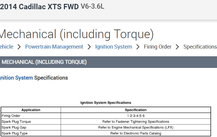

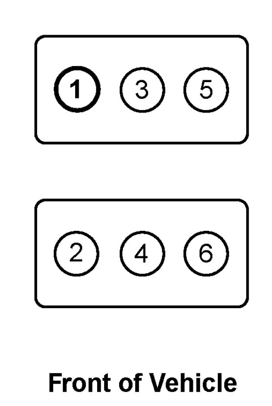

Misfire on cylinder 5 what is the firing order?
2014 CADILLAC XTS
142,293 MILES • 3.6L • V6 • TURBO • AUTOMATIC
JORDAN MRFRED
Misfire on cylinder 5 what’s the firing order?
Oct 18, 2024 at 2:18 AM
  • 55,402 POSTS
Sure here is the firing order and the location of the cylinders to help you find the misfire, this guide may help as well:
