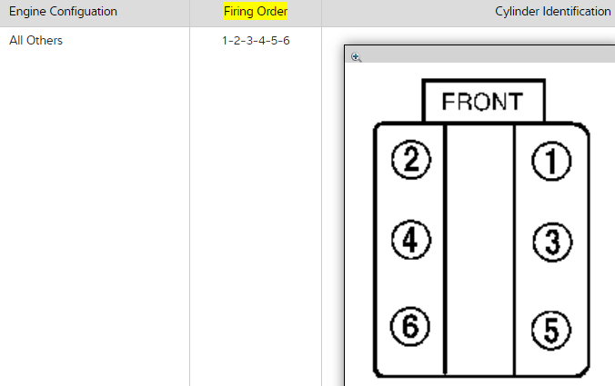

Can you please tell the firing order and coil order please?

The engine is a 6G74
Firing order
1,2,3,4,5,6
See image below.
Cheers, Boris
