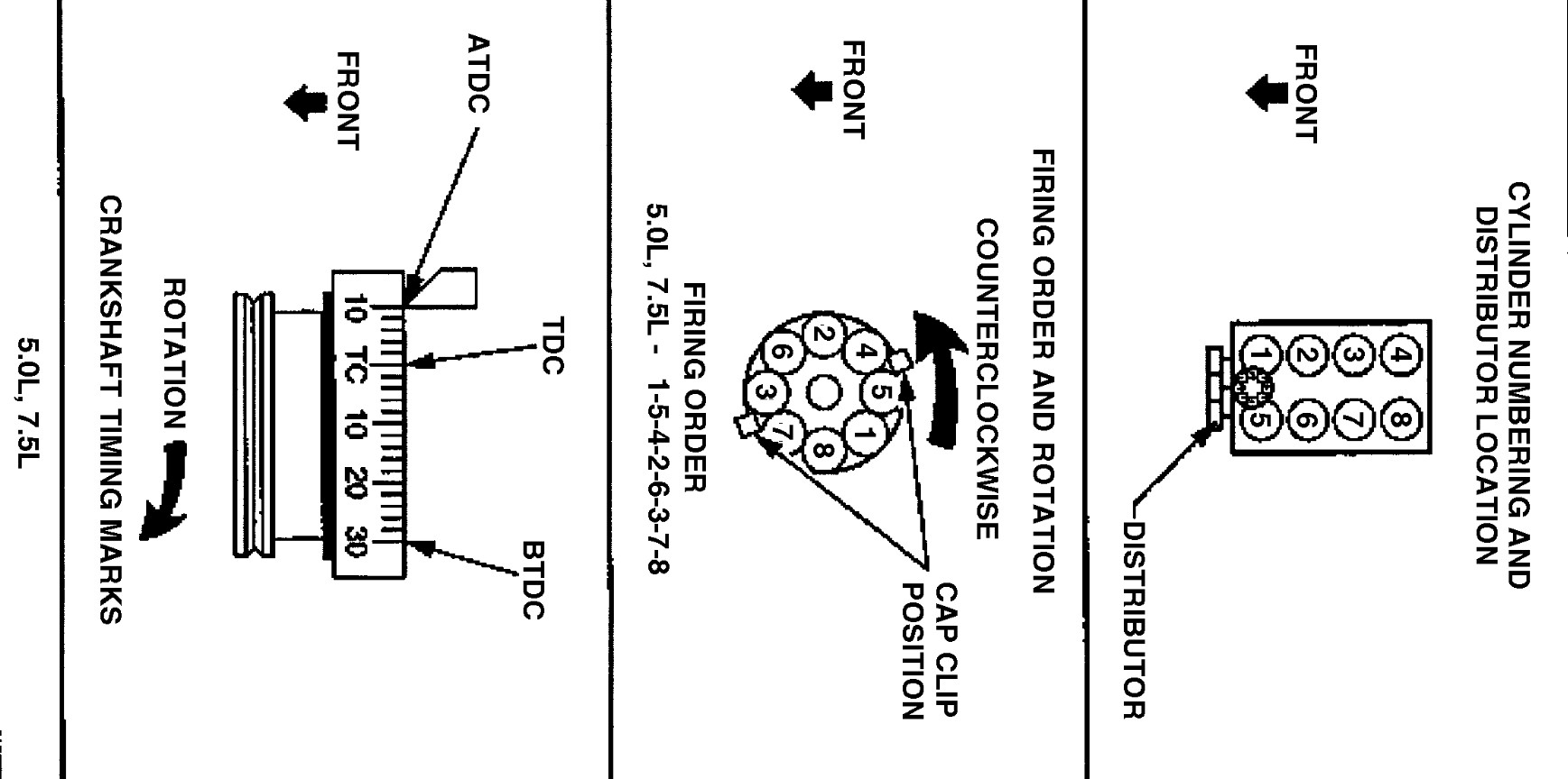

Has a misfire because I changed the ignition coil cap wires and I didn't do it the right way. I need the diagram.

This is the engine layout and firing order for that engine. The cap also shows the wire positions.
