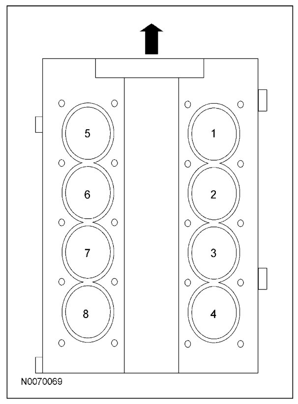

I changed my spark plugs and forgot about the firing code how do I start over with the code.

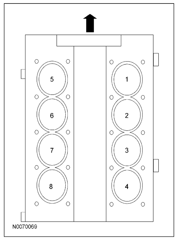

Sure, here is the engine ignition system firing order:
V8 Firing Order: 1 3 7 2 6 5 4 8
Check out the images (below). Let us know if you need anything else.
