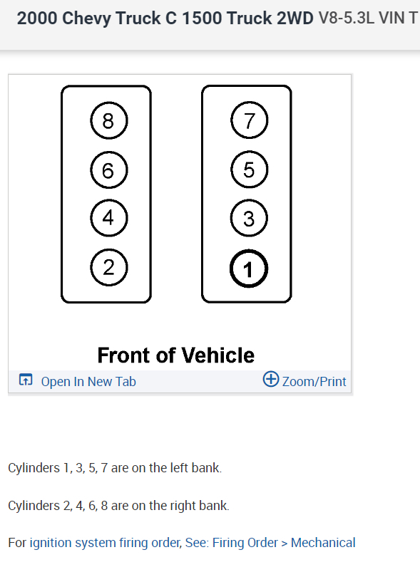

Unsure firing order for spark plugs?
Sep 17, 2024 at 4:23 AM
  • 55,423 POSTS

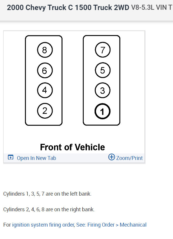

These engine or coil-over-plug there is no order to the spark plug wires, just straight down to the spark plugs. anyway, here is the firing order as requested.
Firing Order .................... 1-8-7-2-6-5-4-3
Check out the images (below). Let us know if you need anything else.
