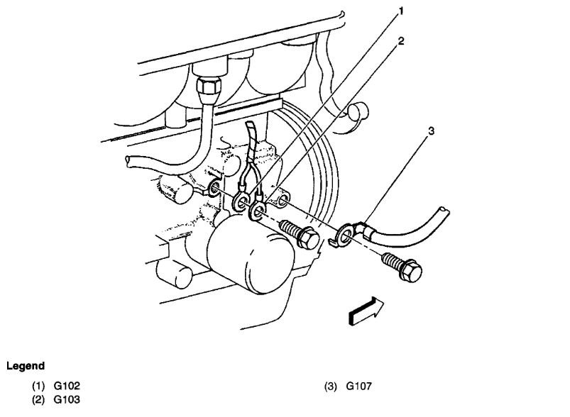

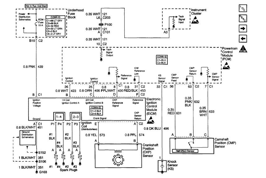

Just installed new transmission and now it will not fire to my spark plugs and the coil packs are new. What could it be?

Did you check all the ground wires? There were ground wires on the bell housing bolts that hold the transmission to the engine.
G103 in the diagram.
